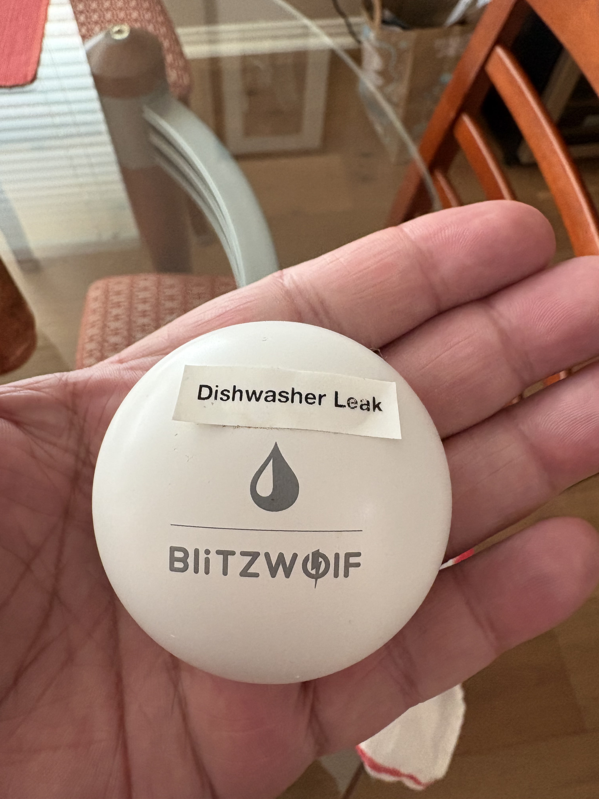

Does anyone know if the Aqara Leak Sensors (Amazon.com: Aqara Water Leak Sensor 3 Pack, Zigbee Water Leak Detector for Alarm System | Requires AQARA HUB, App Notifications, Smart Home Automation, for Kitchen, Bathroom, Basement, Wireless, Works with IFTTT : Industrial & Scientific )work well with HE (C-8)? I'm trying to replace (add to) my BliTZWolF leak sensors as I like the form factor but I can't find them any longer. I found an old thread that I had created in 2021 (!!) where I appear to state that they are the same but wanted to re-confirm.

PS: This is what my current leak sensor look like...

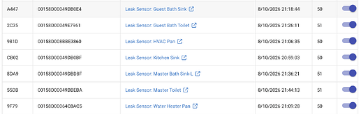

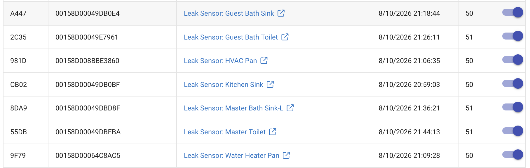

I paired these pretty much exactly a year ago (8/29/2025) and they've stayed paired with no issues and regularly report back to the hub:
