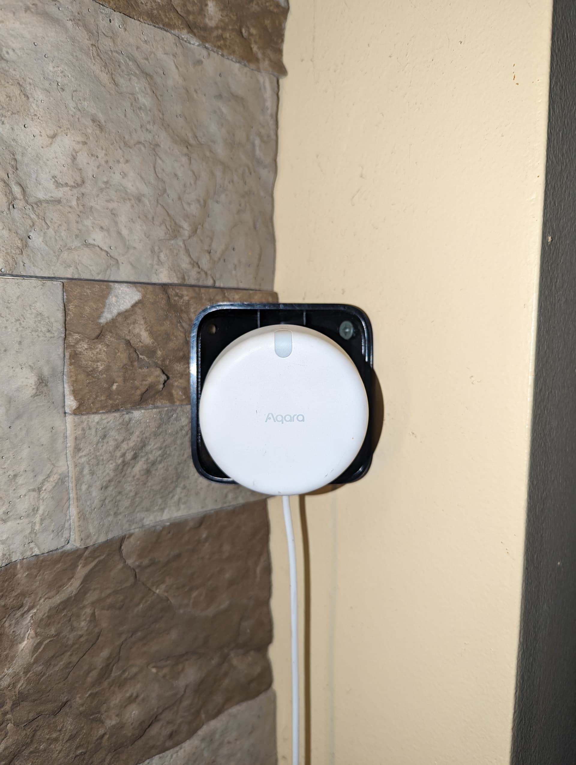

How does it work, do I need an adapter ? Because as far as I know, I can mount the sensor only "normal" and upside down. But for the corner mounting, I have to turn the sensor by 90°.
I used a corner adapter from a Hue motion sensor. I need to find something smaller but it works great for now.

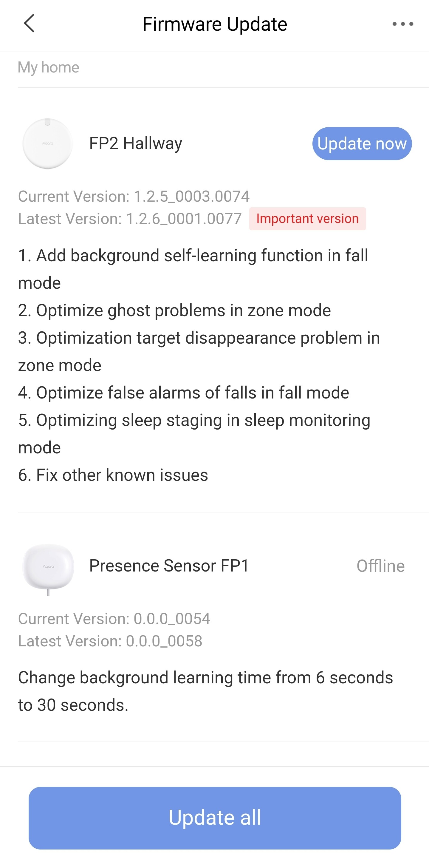

New firmware available..

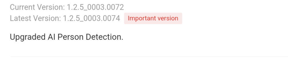

New Firmware update available...
It’s funny how all their firmware version seem to be “Important version”…
I have two FP2’s and the Aqara app is showing both as “up to date” with firmware 74
Do they roll them out in phases? Possibly by server (china mainland vs US etc)?
I’m on the US server
Yes, that’s what it looks like. I’m in the same boat as you. Tells me I’m on the latest update on my 4 FP2’s.
I have read that updates are rolled out in phases, but by serial number not region or server. I just checked and only 1 of my fp2's was showing as needing the latest update. Hopefully the others will soon.

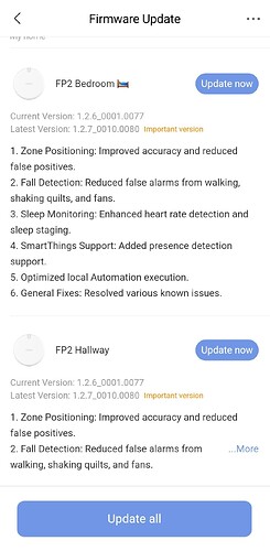

New firmware update available...
