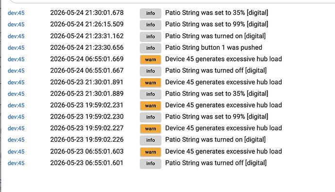

What do the hub logs say around the time these devices apparently missed commands?
Everything I have is either Zigbee or Z-wave, and in the case of the light that didn't come on, it's Z-wave. I didn't think to look at the log, but looking at it now, it's saying something about excessive load on the hub. Looking at it, when it says Button 1 was pushed, that's when I fond they were off, and used the wall switch (which is the actual Z-wav device). Then when it says it was set to 99%, I was usign the Room Lighting app. Dimming to 35% is the normal Room Lighting app doing its thing as it should.
I just did some more digging, and. found others that were having the same excessive load warning on their logs, and rebooting the hub took care of it, so maybe that's why I stopped showing that in mine after unplugging my hub trying to sort some things out.
