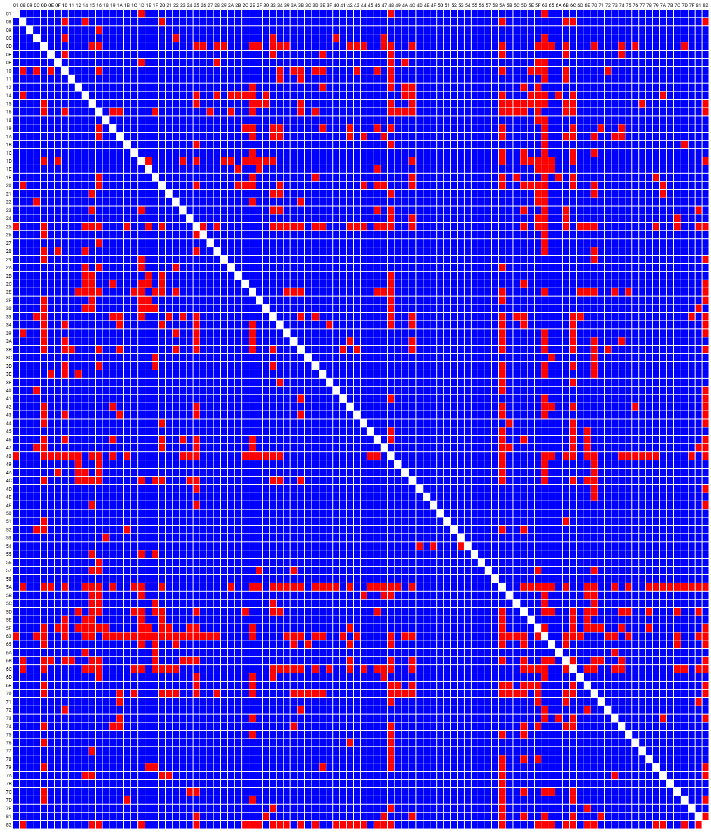

I’m no z-wave expert, but if you don’t remove the ghost, you might find that some of the issues you’re facing never resolve.
I'm working on it.. I have 3 ghosts to get rid of. I'm going to physically take 2 of the switches out of the wall and disconnect power and see if I can remove the ghost. I'm going to attempt to get the Silicon labs software hooked up as well to help. The third is a sensor that showed up twice, I'm going to exclude it and re-include it to get that out. It is frustrating every time I restart the hub, somethings work better some thing stop working and it takes about 2 weeks for everything to work consistently again. The concern is that my second hub doesn't have any ghosts and has similar issues.

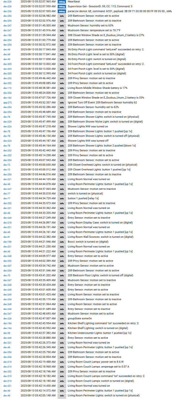

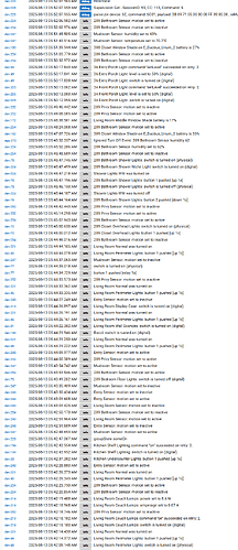

I was able to remove all the ghosts. And for awhile everything got much better, I thought that I had it all working. The issues I have are when the hub is rebooted, all the motion sensors are severely delayed and don't react to run the rules, it's minutes, but once they react a couple of time they work fine. The issue I had this morning is a ran a rule that has been working fine. turn on a physical switch and it runs a room scene, but today I hit the switch and it just turned on the like connected to the physical switch, then I had to hit it again and again until all the lights came on, but the log shows no errors. This happened with 3 other switches that are connected to scenes this morning. When last night all worked fine for turning them off. Here are the logs:
