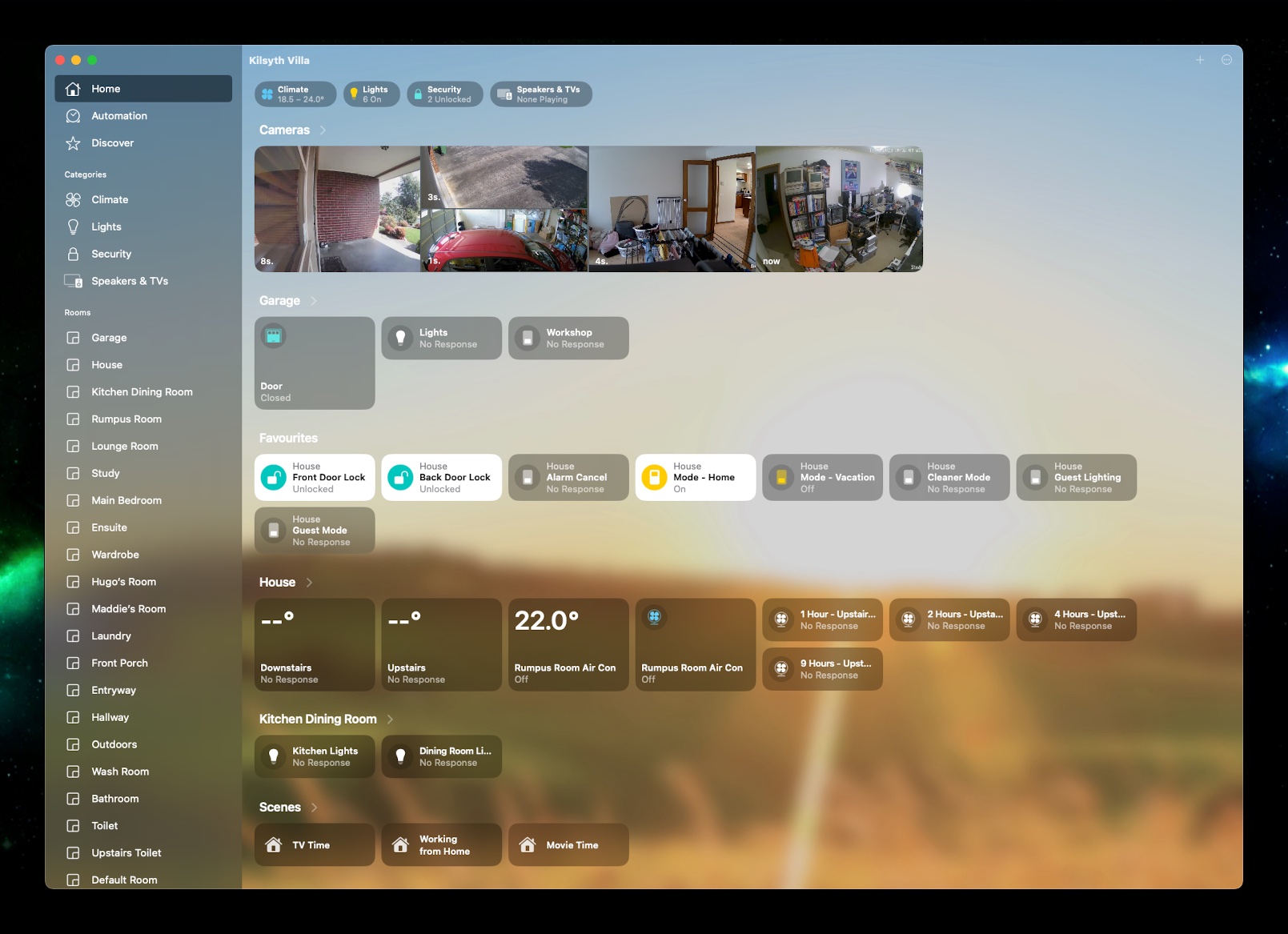

Hi @bobbyD - lately I'm seeing a HomeKit issue where the app appears to be working, but my devices will show "no response". Restarting the Integration does not resolve the issue and I need to reboot my hub to fix it.
Eg: (ignore the working items, they are in HomeBridge)
I see that No Response on devices in HomeKit when the Adv. Hue Integration app loses connectivity with the Hue hub (everything in Hue is brought into Homekit by Hubitat). A small rule waits for the disconnect and then does a refresh to get it back.
With that in mind, I can't quite make sense of what's happening to you, since I gather the devices with No Response are installed directly into HomeKit.
