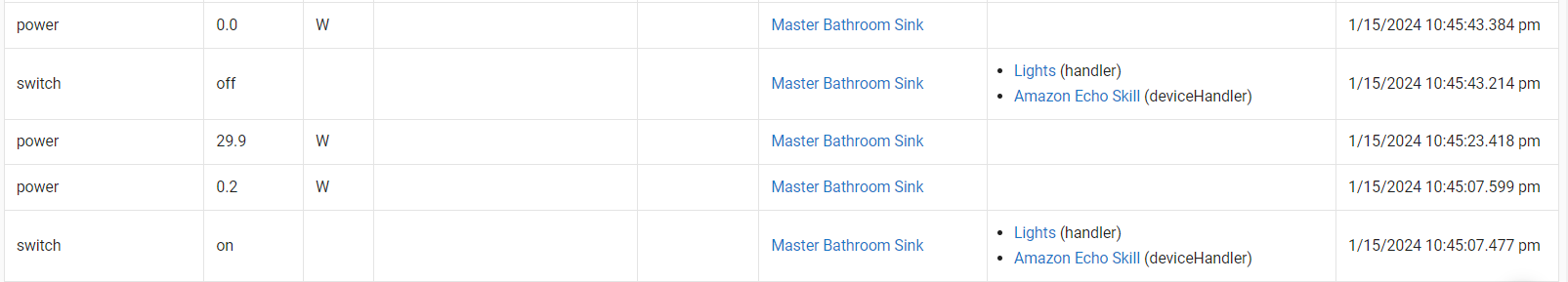

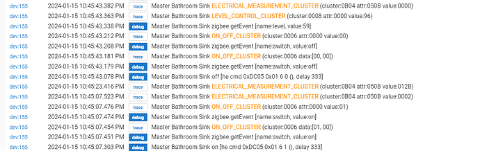

ok. here is on then off from the device tab:

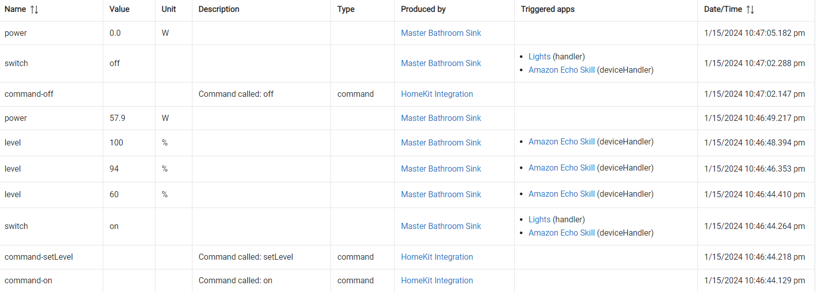

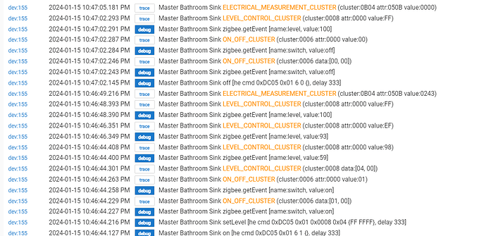

and here is on then off from the home app:

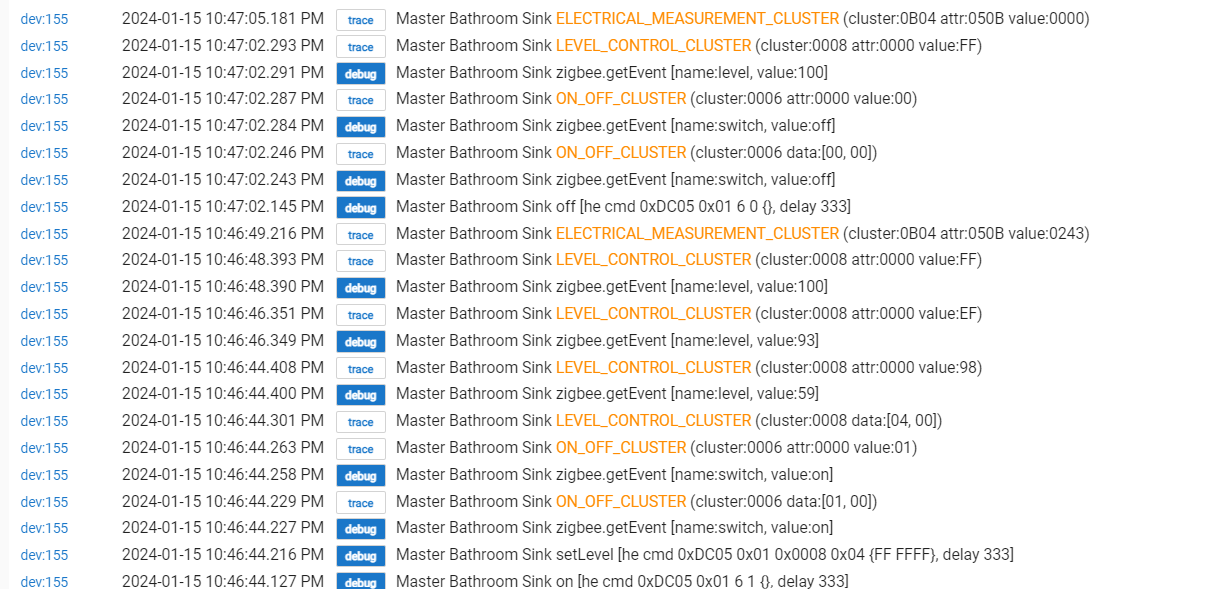

here's the same info from the events tab:

@gopher.ny is this intentional where it does On then setLevel right away or is that coming from Apple Home itself? For some reason the integration is sending a setLevel 100 to the device causing the lights to come on then ramp up to full brightness instead of the last brightness. I dont think I get this with the Homebridge plugin.
