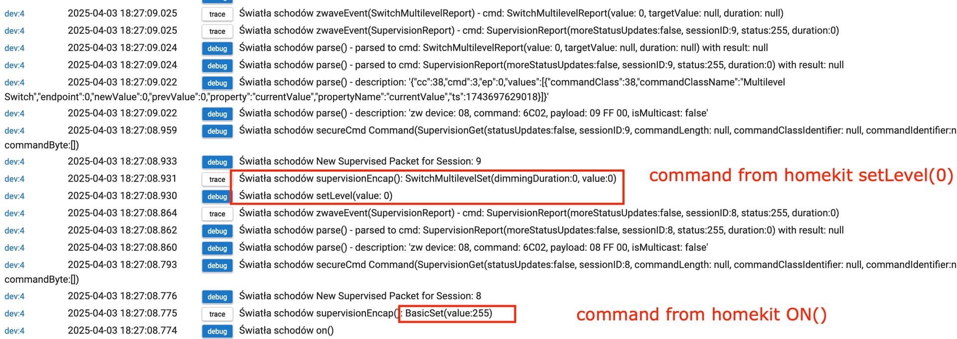

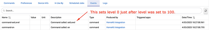

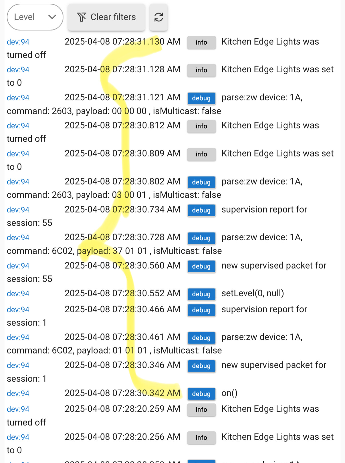

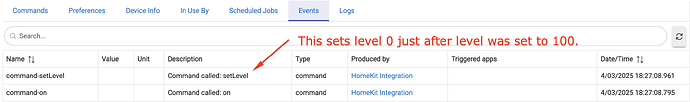

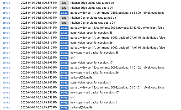

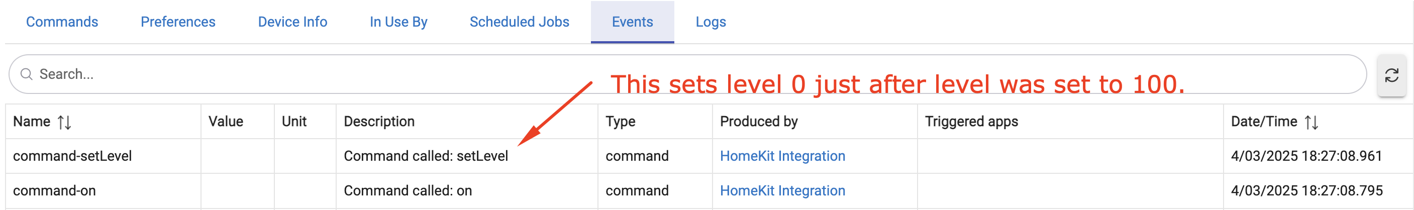

The best thing is that SOME dimmers have this issue and some don't, and I have a hunch why.

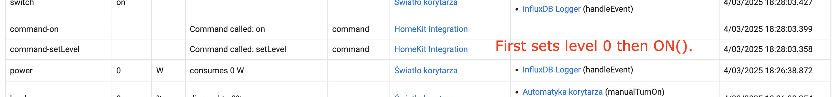

For one dimmer, when I tap "on" in HomeKit app on my phone, the integration sends two commands, first ON and then set level (0).
But for another dimmer, it's in the reverse order:
And for this particular dimmer it just works, because a set 0 is very quickly followed by ON().
My hunch is that you had this bug for a long time, but you changed something that made the order of commands being issued now different, like unordered maps somewhere.
@gopher.ny By the way, why does the HomeKit integration try to set the value when there is on/off command being issued? If the dimmer supports on/off commands, then it is responsibility of the device (or driver) to switch on with the last non-zero level, and this is how most devices do it.

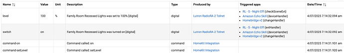

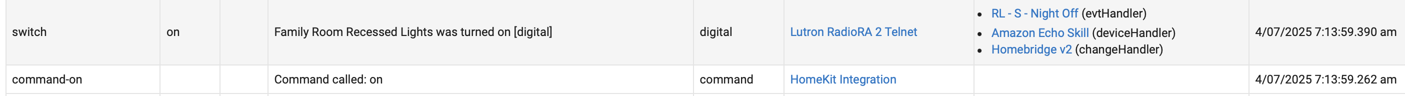

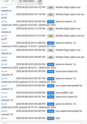

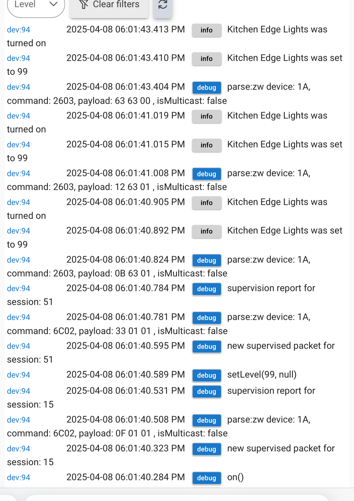

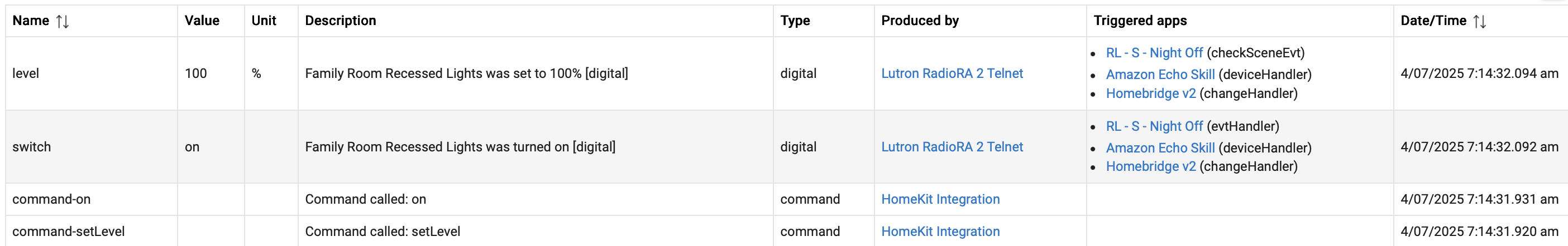

Still an issue with Lutron dimmers. Dimmer driver is set to come on at previous level.
Here is an 'on' event while keeping the Home app open. The dimmer comes on to the previous level as expected:
Here is an 'on' event after closing then re-opening the Home app. The dimmer comes on to 100%:

Here is the on command on zwave dimmer with latest build (2.4.1.155) with the additional logging via HomeKit.
That's all just normal and debug logging from the device itself, nothing from the integration.

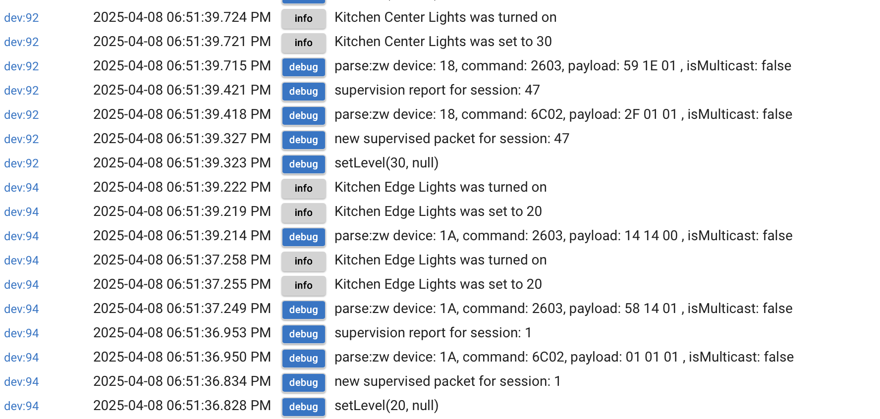

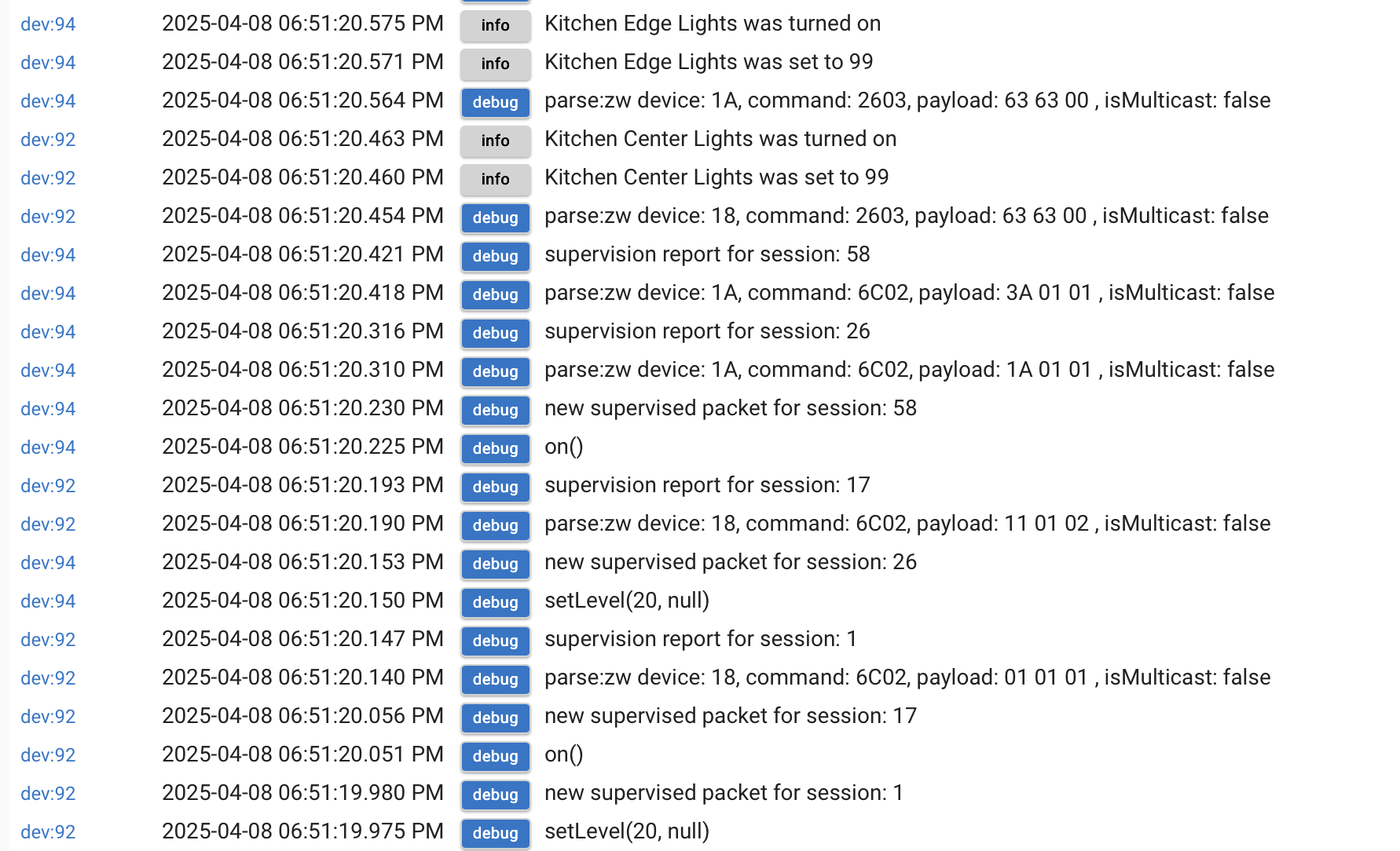

On 2.4.1.156
However, you can see the lights being turned on happening twice…
I think there is room for optimization?
