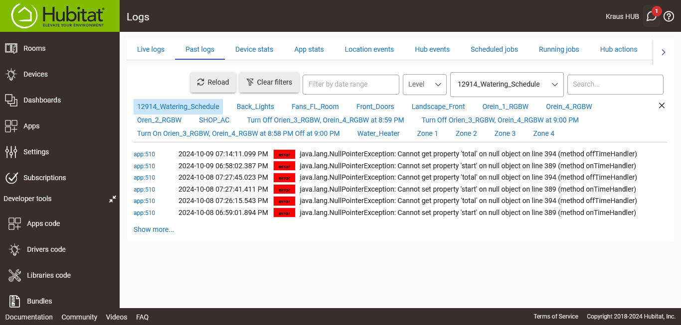

It was a device I was using for testing to deal with some other issues that were fixed.
I went back to Initial Set-Up: un checked the device, clicked update, then clicked Update/Store Schedules .... , then Done. Not sure why its still tied to the app, it doesn't show on the config page.
I couldn't repeat that issue after removing a device and waiting for its previous trigger time to show up. Does it cause an issue with the existing devices or is it just a error log?
If I go here can see the old device still there in the source list but no schedule for it and not listed as in "DeVices" so it wouldn't have tried to trigger.
Did you happen to remove it after it turned on and before it could turn off?

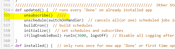

EDIT: Even thought I couldnt't repeat the issue I might have a fix for removed devices sticking around in the source subscriptions. Uncomment line 555 to look like this.
It should trigger around 1900 eastern time.
Will report back.
The device toggled on again.
I could not repeat this type of error so its tough to find. You make that change and update and hit done? Im sure there are situations I haven't tested so your feed back is valuable.

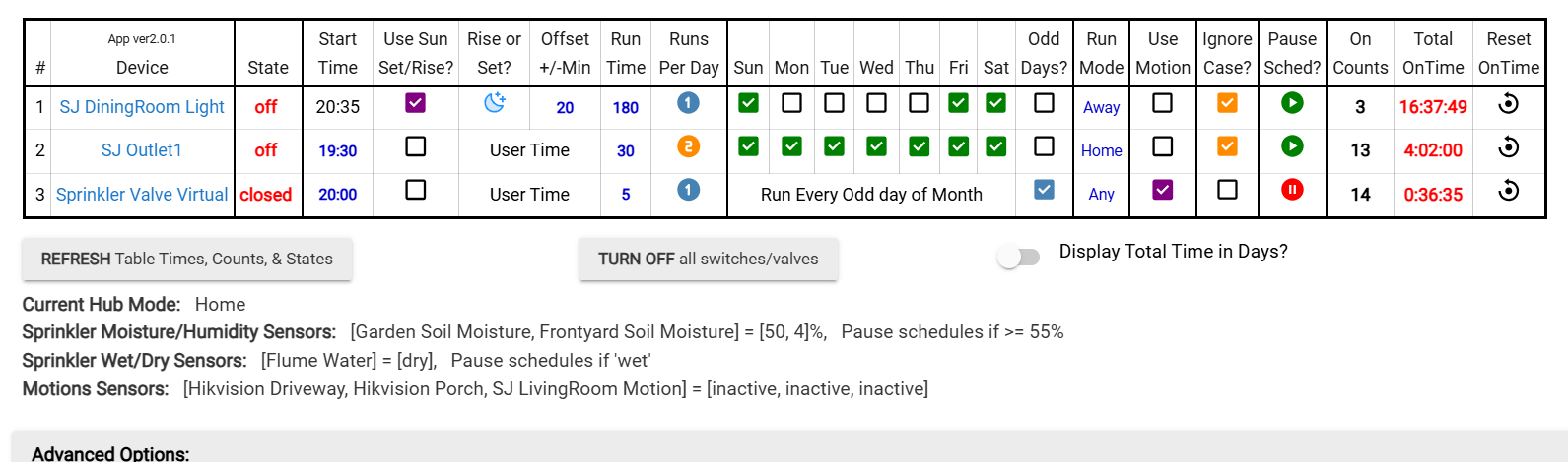

As far as the other devices its kind of quirky the way they are working.
Zone 3 shows an on count of 4 and it should only be 2. Zone 4 shows a total time of 30 and it should only be 20.

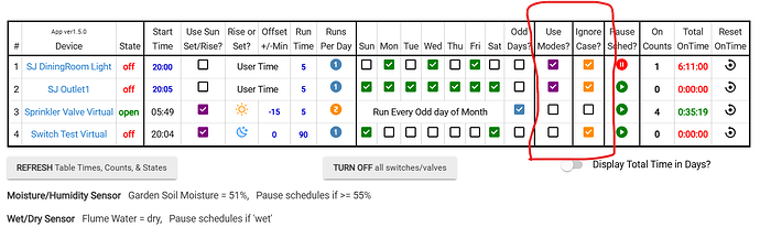

Two new features added:
--Ability to select which devices use modes. Adds the ability to run schedules normally or have a single schedule you only want to run when away like a night security light. All within the same table.
--Ability to Ignore a pause cause. This allows to to more easily mix sprinklers and lighting in the same table. So if Ignore checked that device wont be paused say if your sprinklers moisture sensor threshold is reached. Requested by @greghoward1962.
I've tested parts of it but not everything yet. Ver 1.5.0

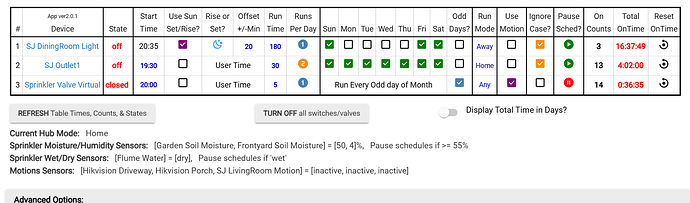

Ha!!! Now that I added single mode(home, Away..) selection per devices I have a use case at home where I want different modes for different devices.... Need to think about how to make this new implantation, it never ends.. A drop down menu for modes in the table? No idea how to do that..
Added a few more options for some use cases I have around the house. Uploaded to github ver2.0.1

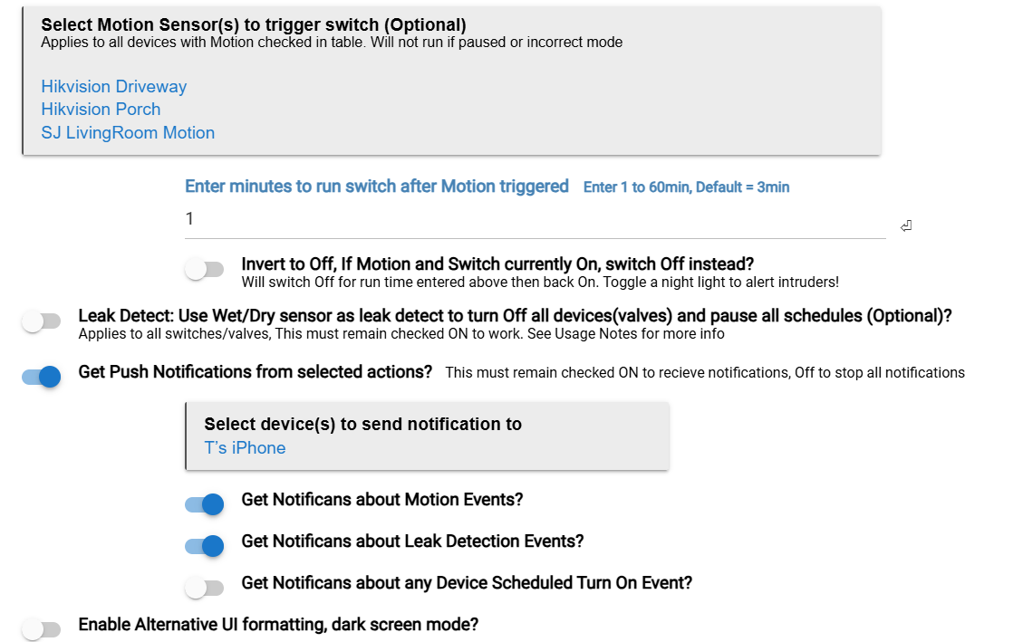

Per device added modes and motion. Added notification options. Added wet sensor leak detect shutdown.
New Options
