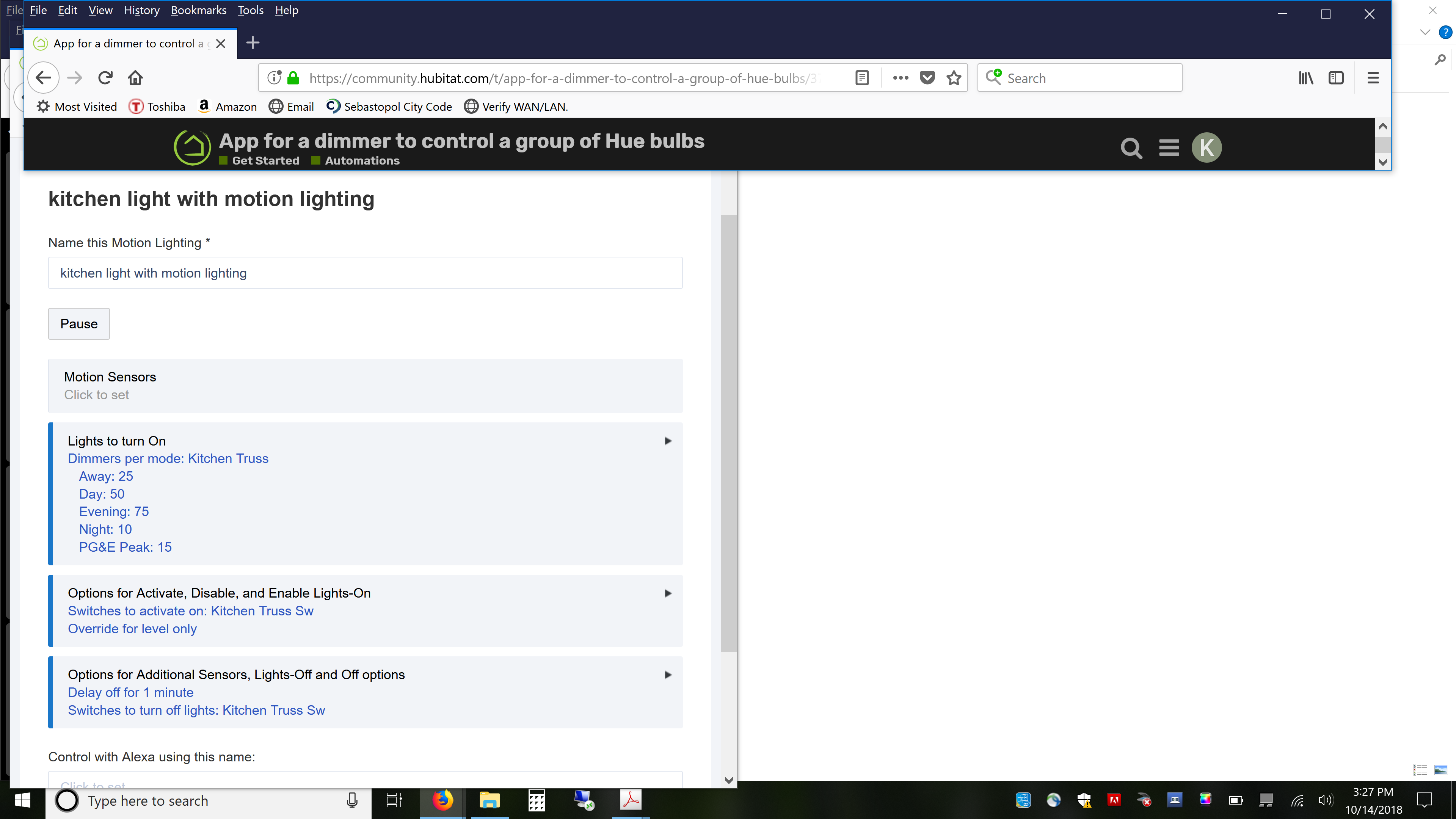

That would work for what you've shown so far. Omit the motion sensor --> it's irrelevant. Select your real switch as both Switch to turn on and Switch to turn off. In the example in that post, that is done by Powder 1. You can do what you want with the modes, depending on how you are using them now, if at all. If you just leave your system in one mode, then just set it up for that mode.
If you change the dim level of the switch, the dim level of the light will follow.
Thanks. I got the light set up as follows, and the on/off works, turning the light on at the % specified. (in combination with the other rule to change the dimming level). Follow up questions: - is there a way to 1) get the on/off rule I just made to just turn on at the previously set dimmer level (as opposed to the set percentages in the motion lighting)? often that is preferred to me - if, as a user, I find a nice level for how sunny or cloudy the week is, it's nice to have that particular level 'stay' as the light level for that week or so, without having to go into 'coder' mode. Or 2) combine the off/on with the dimming tracking previously created (also trying to get to the same ideal, thinking if it were possible to combine into rules - it would help with the first question/ideal of remembering whatever light level was last set).
