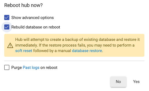

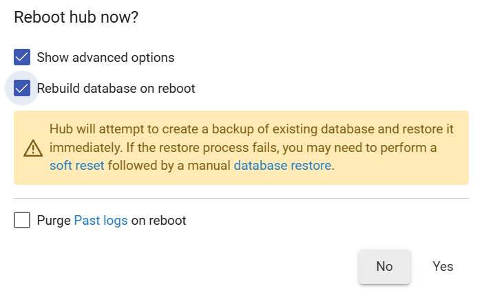

Start with a Rebuild database on reboot.
That is why I was asking how they were rebooting and why they were rebooting in the first place. Some have thought the only way to reboot was plug pull and were not even aware how to get to the settings -> reboot -> advanced options.

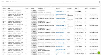

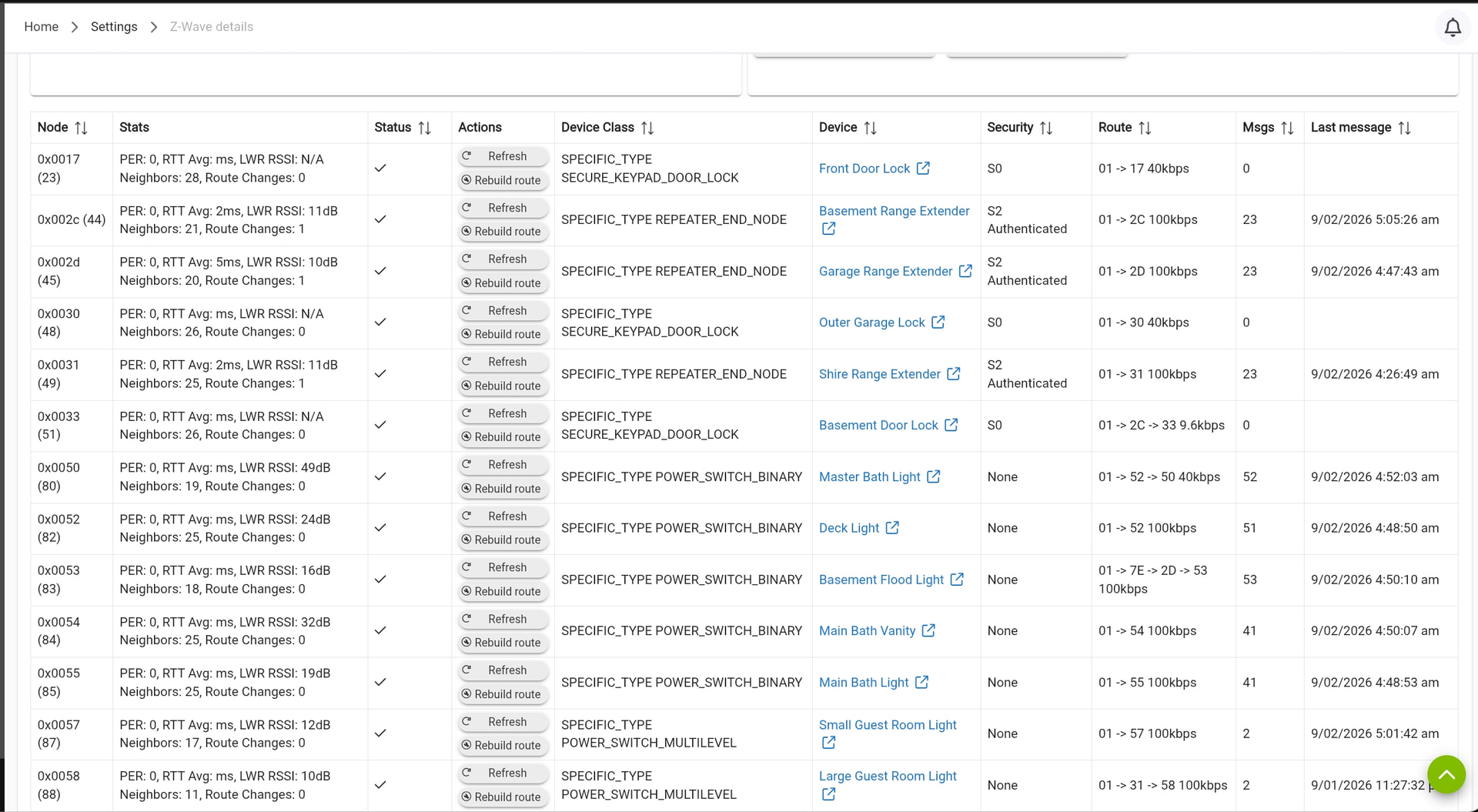

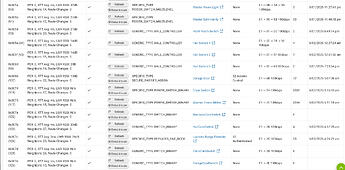

Can you post a screenshot of your entireZwave table in Settings-> Z-Wave Details
Also, consider adding the additional information as suggested in the link I provided earlier
As @tray_e asked , please post your z-wave details page in its entirety. Settings>>z-wave details
