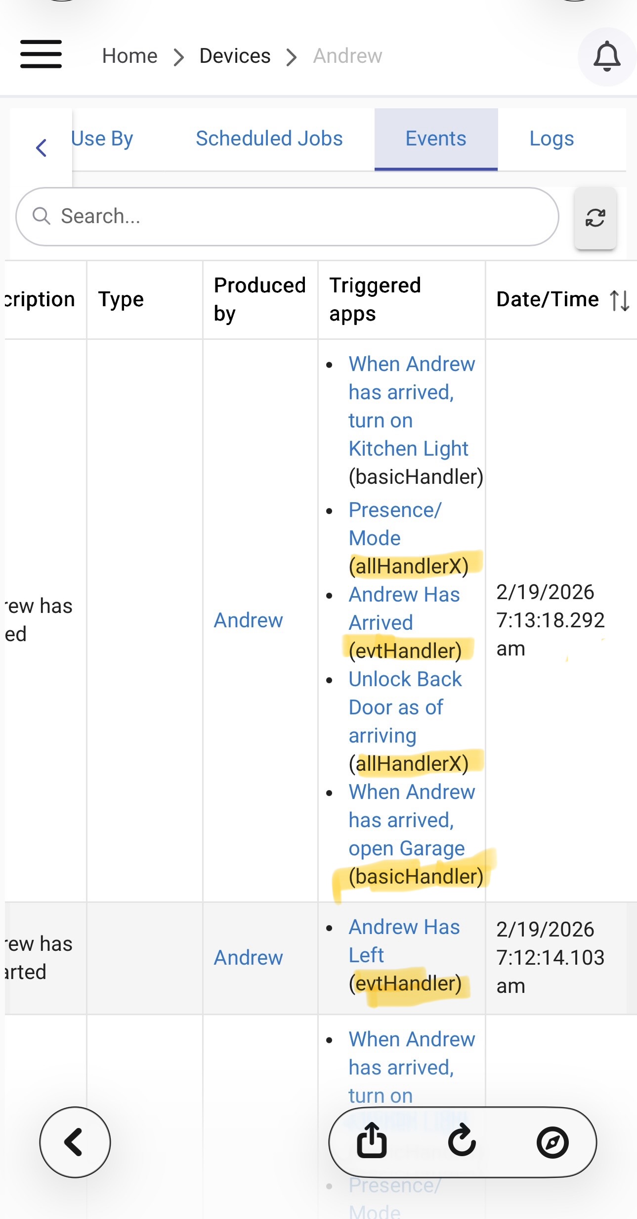

All location based automations stopped working it doesn’t show that I’m present or not present. If I go into devices and manually to command it it works. I had both hubs hooked up. The new hub had a different IP address so when i transferred to the New hub, I went into the router and changed the new hubs IP address to the old hubs ip cause I had it set up as a static IP i will post a pic of what is shows cause it’s showing stuff I’ve never seen before
So although you only answered one of my several questions, your logs seem to indicate geofence is working. At least the hub is aware of your coming and going.
It looks like your problem is that the changes in your location are not executing the assigned automations.
Witch other questions didn’t I answer I’m not quit sure how else to explain it
Yes it seem the logs are showing my Coming’s and goings but that’s it but not executing the automations
I’ve tried to redo the automations, but that still did not work, so how do I fix this problem?
That would be best answered by re-reading the post. However the screen capture of the logs infers what the answer to those questions would have been.
