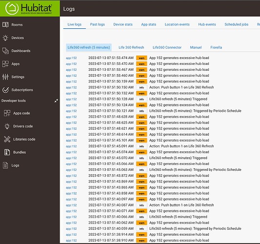

App 152 generates excessive hub load
Good day all,
My Hubitat hub has taken a mind of its own and it is arming my alarm and triggering my sirens for no apparent reason.
I've noticed this in the logs, just not sure how to see what application 152 is but my gut feeling tells me it is the Life360 sensor which runs every 5 seconds.
The rule name says 5 minutes, so not sure when that changed to 5 seconds but for sure if I did change it to 5 seconds, I probably did that a while back, so not sure how the problem starts to happen now.
Any help would be very much appreciated.
Thank you
Your logs indicate that app 152 is your rule to refresh Life360 presence.
This is a cloud integration, so the app polls the Life360 cloud. Perhaps something is currently delayed in that cloud polling (eg. your internet connection is slow, or their cloud servers are slow/down). Conditions like these will increase the hub load because successive iterations of your app are logjammed
If you need such rapid polling, I’d suggest writing a custom app that uses some sort of a back-off timer when timely responses are not received.
Alternatively, is it really necessary to run this rule that frequently?

In your first screenshot with all the log entries, when you tap the blue 'app:152' link to the left of one of the log entries, it selects and highlights that app name at the top of the list and filters down to just the entries from that app.
So in your case, app 152 is "Life360 refresh (5 minutes)" which per your second screenshot appears to be a rule to refresh the status of that integration.
