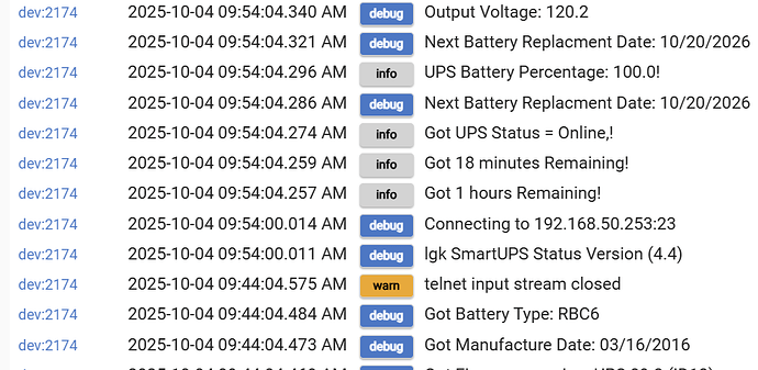

Separately, now that I have multiple devices using this driver (SMT1500 and a couple little brother SMT750s), I’ve noticed an odd edge case with the UPSStatus attribute. Sometimes the cap case varies across devices (e.g., OnLine vs. Online) and sometimes there is a stray comma (Online vs. Online,). I’m guessing this is due to different firmware versions. I haven’t checked yet because it’s straightforward to solve for these variations via rule machine.
Still, figured other folks might want to know rather than learn the hard way :wink:
it should already handle the various onlines so i need in the output of a telnet window whilch is not working.. its more likely a telnet issue as getting data back from telnet can be flakey..

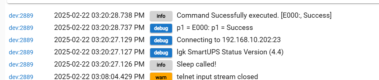

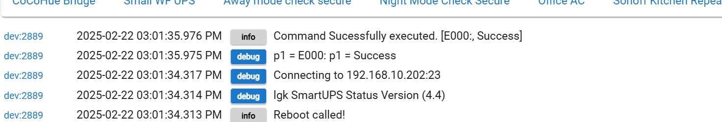

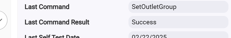

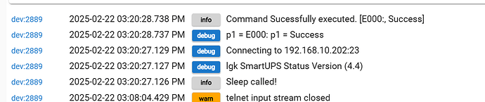

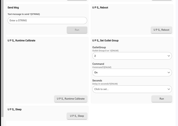

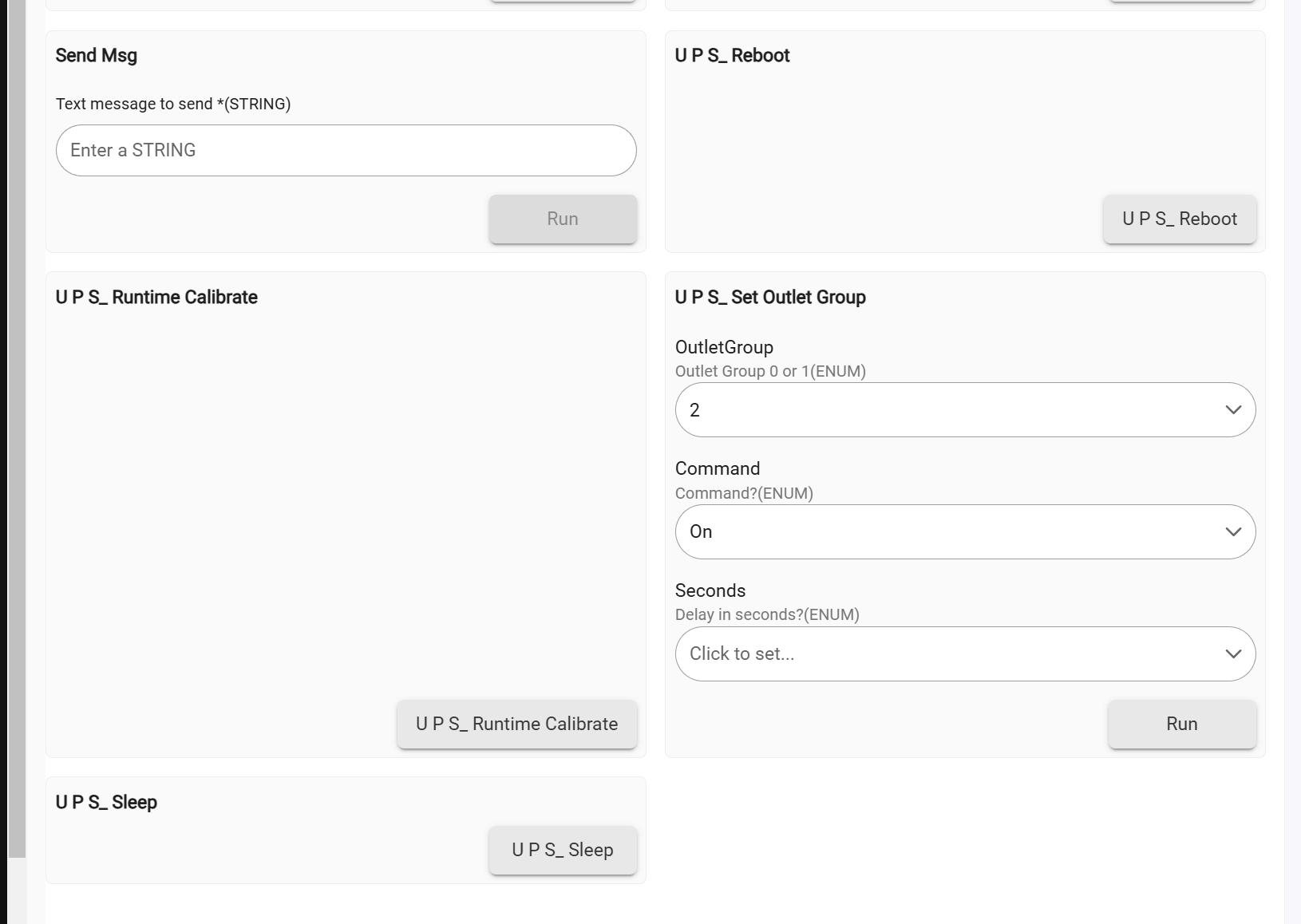

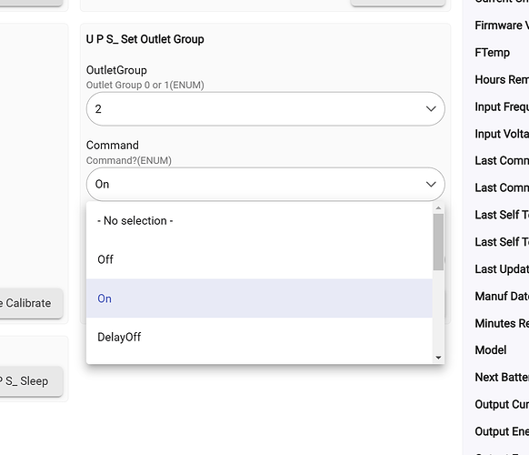

Anyway, here is a new version in github that implments the sleep, reboot, startcalibration and outlet control commands (UPS -o)
again it can be flakey based on how fast telnet responds or sometimes never responds.
for this reason i implmented a lastCommandResult attribute (see below) so if you are writing rules you will need to delay after issueing a command and check that attribute (its reset to NA before each command is executed)

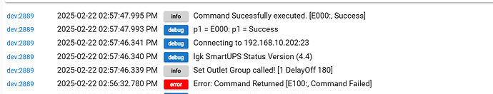

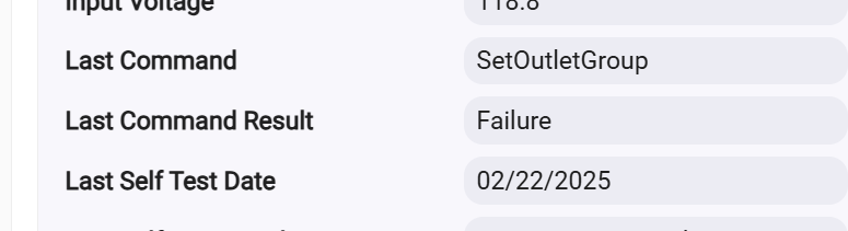

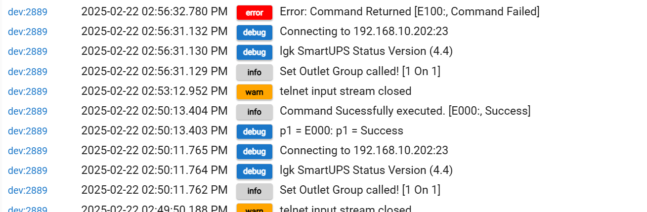

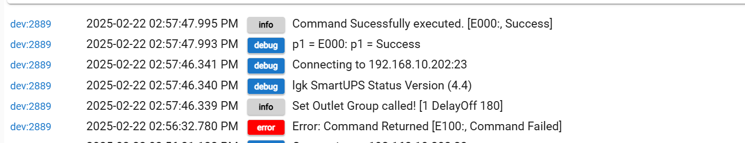

Caveats: you will get failures if you try to turn an outlet group on if already on or off if already off. You will also get failures on some of the smaller ie 750 ups trying to do outlet group 2 as many only have one outlet group.

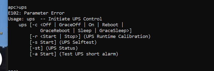

and also some firmwares do NOT have the ups -o command (see below) which will also cause failures.
this card firmware does not have ups -o command:

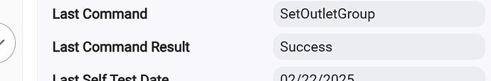

Thanks for this — I haven’t yet got the driver replicating the NMC’s outlet control, but I believe it is because of APC firmware issues, exactly as you warned. I’ll need to take more time when I’m back in town to sort this out. Will revert. Appreciate the changes regardless!
@kahn-hubitat Larry, this works great, thank you!
For those who may be interested in output outlet control, in my testing (SMT750 and SMT1500), I had to be on firmware v9.2 or greater for the UPS and v7.1.8 for the NMC. Below those releases, it wouldn't work for me. Can't swear it wouldn't work in any earlier versions, but this was my experience.

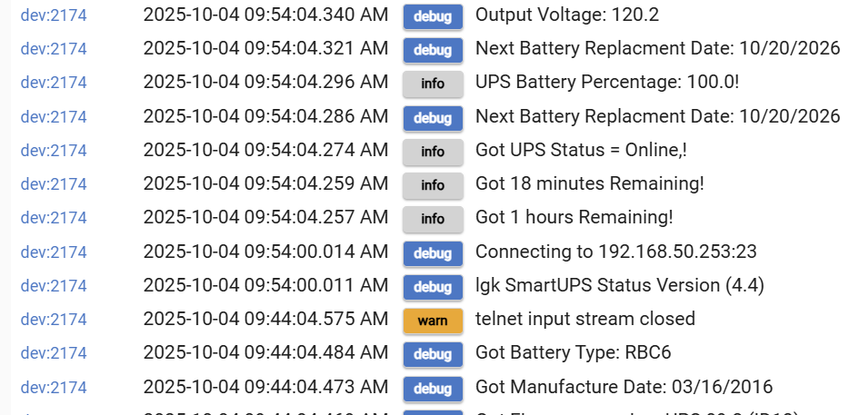

new version 4.5
found in one of my ups firmware it was coming back with
Online, (small l with a comma) I already handled the case with the large
L and a comma, but this was new.
so standardized it again to OnLine
ie

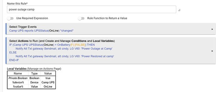

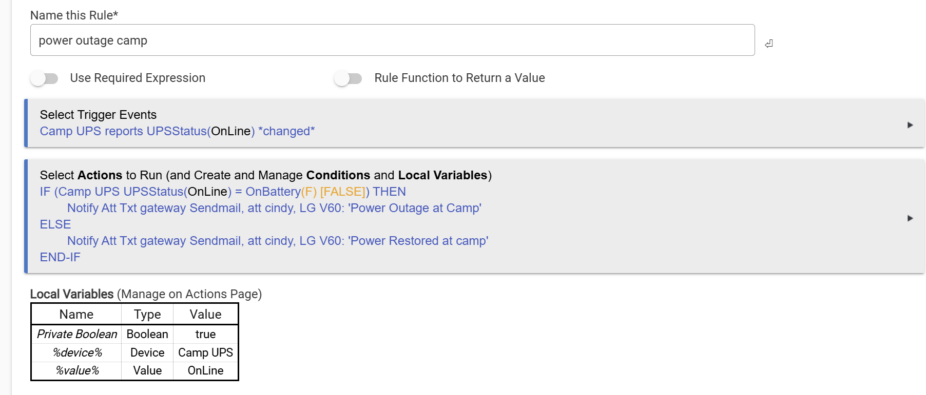

really not a big deal but my rule to say the ups was backonline when it upsStatus changed and was not OnBattery was firing at times and alerting me for no reason.
ie

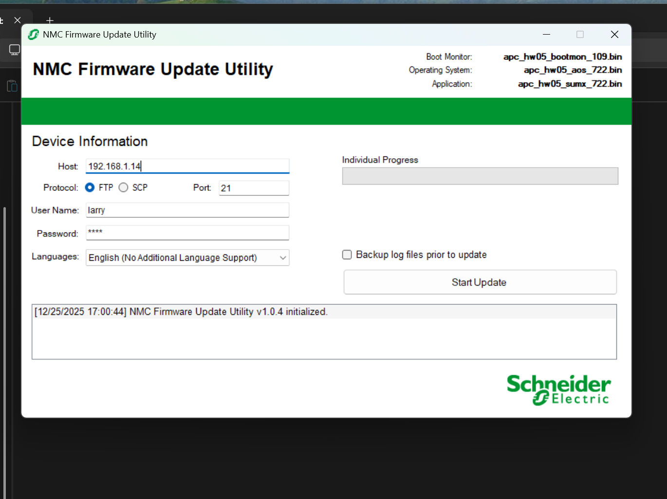

for everyone using this:

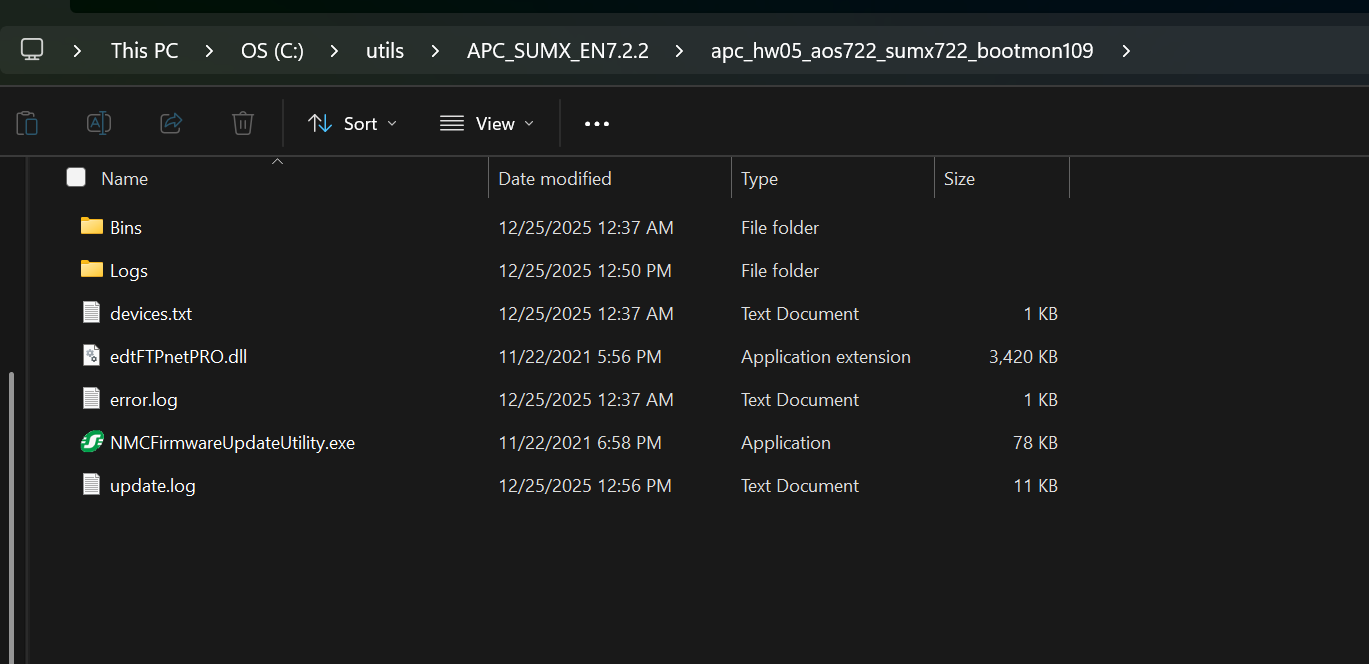

apc has released a new firmware as of sept this year version 7.,2.2. for all 9630 and 9631 net cards.. It works fine with my app.. Just updated about 10 ups's
Thanks for sharing that. FWIW I find APC's documentation to be impenetrable to the human idea, and this one is no exception. Do you have a POV on the redeeming attributes of this release that you'd be willing to share?
just download the excutable and run unzip the file. then run the executable. it creates a directory and inside that is anothre executable you run in windowsw..
make sure through the web interface/ configuration/netowrk/summary you have enabled ftp in the ups .
then when running the app put in the ip address of your ups username and password and change it to ftp and hit start update.
