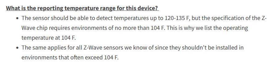

Well, yes, my observations are that it actually goes no longer than 5F. As I recall the FAQ also mentions that the sensor has a temp range than 104F, which is not that high. Hmmm....maybe I'll look in that direction. Try to find that chip spec.

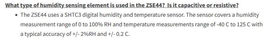

edit: This is the FAQ reference:
A little farther up in the FAQ says the sensor can go down to -40F.
So, maybe it's limited by firmware.

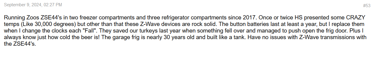

It's tracking the defrost cycles nicely.
I found this on a Homeseer forum.
And that'd wouldn't be the latest LR enabled chip.
