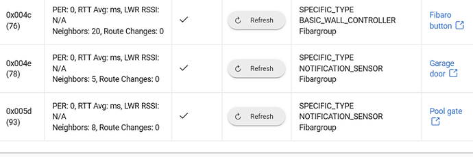

Are you experiencing problems or just looking at the stats? The automatic update for these stats no longer runs the same way it used to, and there is a button on the Z-Wave Details page to update them on demand.
So the difference alone is not concerning. This does not affect actual functionality.

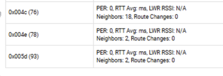

no problems just looking at stats.
back in nov 16th, by 3 non repeater devices had alot of neighbours.
as I understand it, the more neighbours the more stable/fast the mesh right?
Maybe not related the update, but why did my neighbour count drop alot?

Z-Wave routes change as nodes re-evaluate things. The reasons are not always clear to human observers...
But the stats also do not update the same way they used to. Try the "Refresh Statistics" button at the top of the Z-Wave Details table if you want newer data.
However, if you aren't having problems, I wouldn't really concern yourself with any of this.
