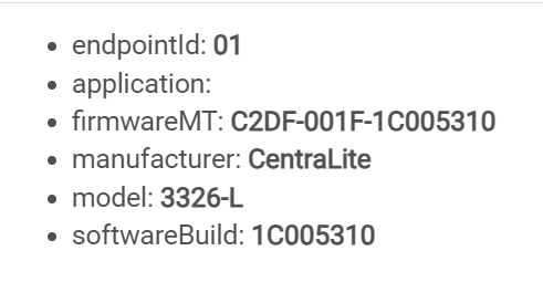

What FW version do yours show? Mine all appear to be on:
firmwareMT: C2DF-001F-1C005310
softwareBuild: 1C005310
Like @ogiewon I purchased an Iris hub before the shutdown and upgraded all of my devices. My v2 motions are all:
  • firmwareMT: C2DF-001F-1C005310
No problems with any of my Iris V2 motion or contact sensors either. I’m using channel 19 and power level 16. I also had to repair one of the motion sensors recently due to a dead battery, and couldn’t get it to pair in place. I had to bring it closer to the hub to pair.
FYI: I have only had issues with the v2 motion sensors (as far as I know) my firmware is:
manufacturer: CentraLite
model: 3326-L
Yup - exactly the same FW as mine...as I noted above, these types of issues are often YMMV which makes them that much harder to root-cause/determine a specific fix (and there may not be one).
