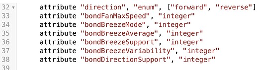

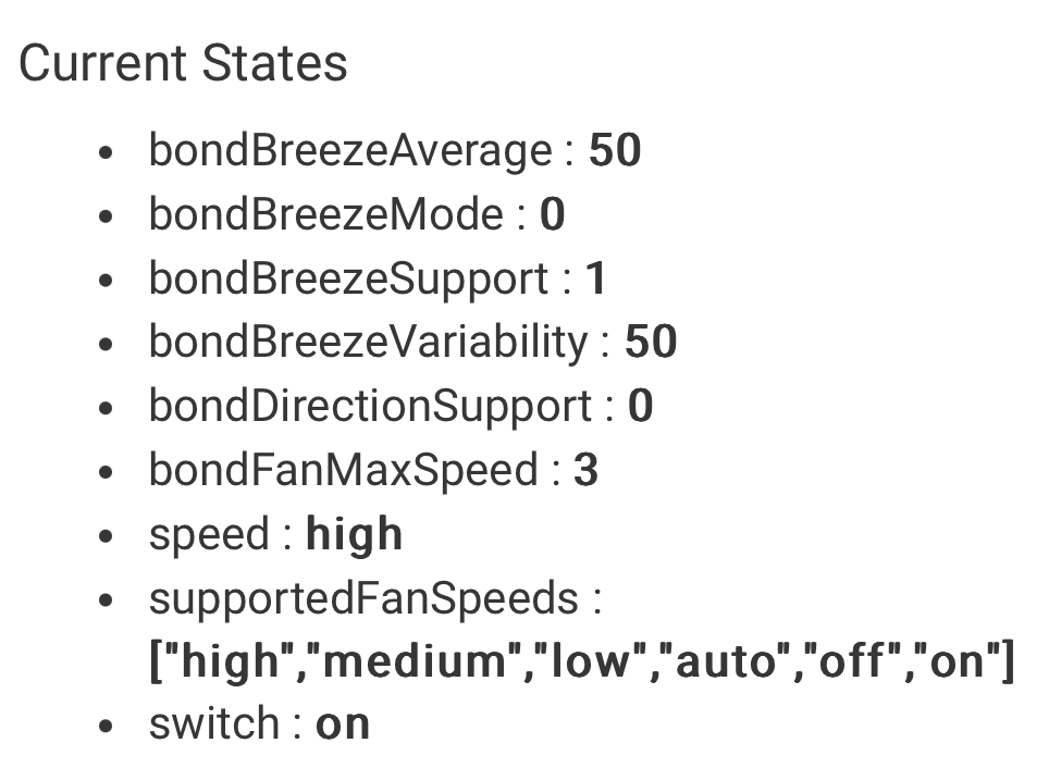

Here are the Attributes/ Current States:
Here are the definitions:
Let’s look specifically at bondBreezeSupport which is declared as an integer in that code snippet.

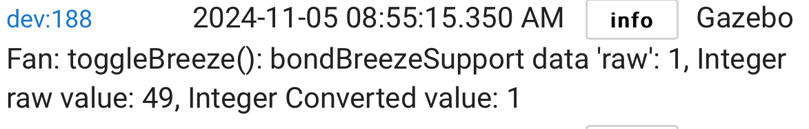

However, when later retrieved it is not an integer:
def junk = device.currentValue( "bondBreezeSupport" )
Integer junkInt1 = device.currentValue( "bondBreezeSupport" )
Integer junkInt2 = device.currentValue( "bondBreezeSupport" ).toInteger()
logEvent( "toggleBreeze(): bondBreezeSupport data 'raw': ${junk}, Integer raw value: ${junkInt1.toString()}, Integer Converted value: ${junkInt2.toString()}", "info" )
Result:
Note the raw value of “49” which is the ASCII code for the character “1”.
I declared the attribute an integer and sent it an integer. Hubitat does something expected, intelligent and displays a visual “1” (the user can read the intended value).
However when retrieved, I as the developer need to know all attributes are really strings regardless of declaration or actual data type submitted. That’s kinda important when doing numerical comparisons. It’s also not clearly documented behavior. It turns out Hubitat (not Groovy as far as I can tell) did a full on data type conversion on storage.

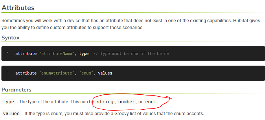

Except, "integer" is not a valid data type for an Attribute.
From the Hubitat Documentation
Fair point, although were it I to use number what should I expect as the behavior? I likely missed that copying examples from other's code which is also why I'm not a huge fan of learning by reading non-official code.
Intuitively I would expect the data type going in and coming out to be directly usable in a mathematical context, otherwise it's an alias for "string". I'll have to test it.
It's also another example of the Hubitat environment being maybe too forgiving.
Edit: validated that using "number" provides the expected behavior without developer type conversion post retrieval. My bad for trusting other code samples and not cross referencing the correct documentation.
Yes, from what I found a "number" type is like a generic type for any integer, float, double etc. You have to turn it into the the type of number you want when using it.
