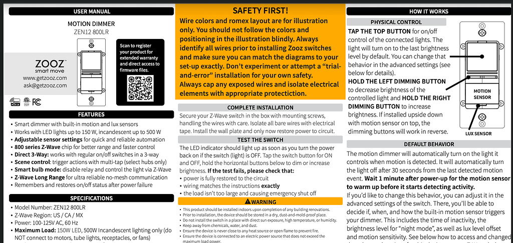

I’m sure it is detailed somewhere and I am missing it - can this switch be programmed as off/on only (no dimmer function)?
Yes. Via parameter 44
Here’s the full parameter list and manual
FYI that it is posted on the alliance website now too.
