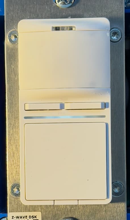

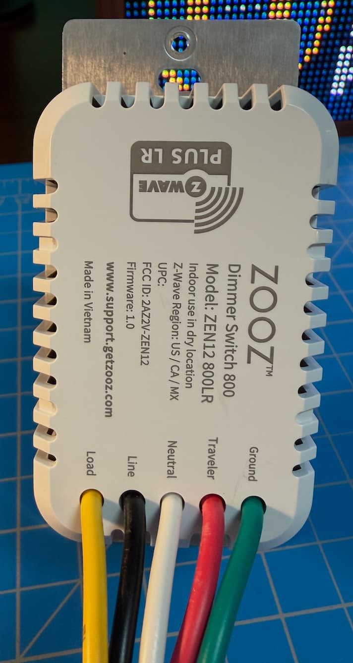

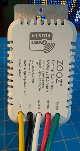

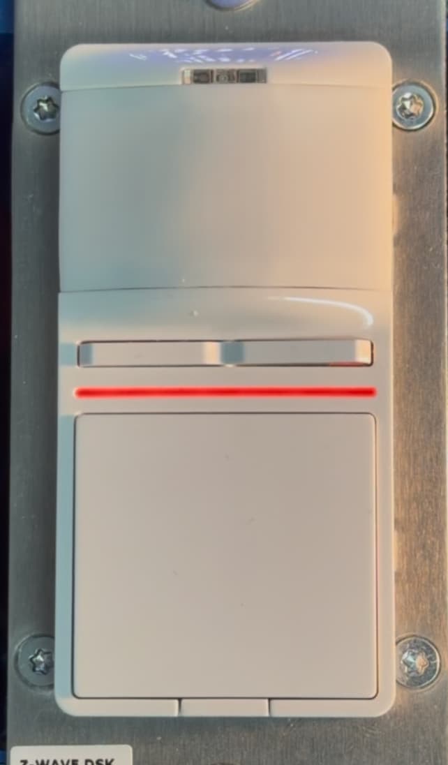

I am lucky to have in hand an actual ZEN12 beta unit. I've been evaluating it, and below are some unexpected findings and a few pictures.
I've been told a release is planned for sometime in mid-April 2026.
  • Many configurable parameters allowing for button up or button down installation, configurable triggers and timers, etc. With all the normal features similar to other Zooz dimmers.
  • Lux sensor determines day/night behavior, and acts as an independent sensor.
  • 3-way wired support similar to the ZEN76
  • Multi-touch scene control from each of the three buttons; and (I believe - not tested yet) the ability to trigger scenes from a remote 3-way wired switch.
  • Multi-segment LED display; ability to change colors and behavior. I suspect it could be used as a notification method for elsewhere in the home (not yet tested)
I'm on a beta firmware, but I'm expecting an upgrade to production firmware will open up a few additional options before official release.
It seems that ZEN12 driver was added in 2.4.4.129, so it does show up as a dimmer, motion, illuminance sensor, and button device which is very cool! (Most other z-wave platforms did not have a driver already for this device!)
However I could not get the device to produce multi-tap scene control events in most ecosystems/controllers (I did have the scene control parameter enabled) so I'm assuming this is a pre-production firmware bug.
I can say I was leery about the motion being PIR, but I find it to be extremely accurate. It never has missed a presence event in the week I've had it installed.

So looking at the picture of the front, not 100% sure I like the "Inovelli style" LED bar instead of the discreet "Zooz/Lutron style" LED dot(s). I've come to love this very clean look instead of a bar that I had on my first gen Inovelli dimmers and eventually got rid of and replaced with the Zooz dimmers. If they would have used 5 individual "dot LEDs", that would have been very nice and really hope they reconsider this decision in the next designs.
If I ever need to get one of these, I would most likely try to get a mask made out of vinyl with small holes and cover up the bar for sure.

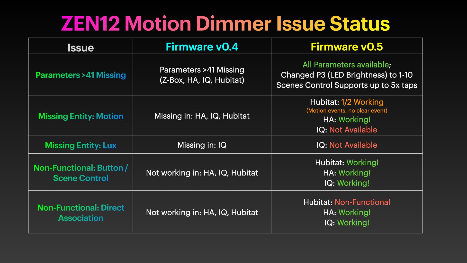

Following up on my earlier post. I've since received Firmware 0.5 from Zooz and completed a full retest, including a dedicated Hubitat re-test segment.
The improvement over the pre-production firmware is meaningful and things are looking considerably better under 0.5.
The new video is below. The Hubitat retest starts at 3:26 if you want to jump straight to it, though the firmware intro and Z-Box segment before it give useful context on what actually changed.
Here's the link to the video
This table shows the items repaired/improved with this latest firmware based on my testing so far.
