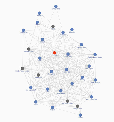

My zwave mesh is quite good and reliable. So prefer something that feeds from the mesh.

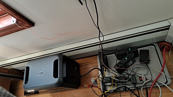

If you are comfortable with soldering you can solder a pair of wires to the button and โ€œpressโ€ it with a dry contact relay. I have done this on several things in my house and many do it with garage door buttons and remotes for local control.
the relay is zwave?
send a picture please.
Here's what I have:
A remote for the gate is on the window sill.
Wires go from the remote to a ZEN16 relay.
Could be powered by battery, I suppose, but not compact at all.
