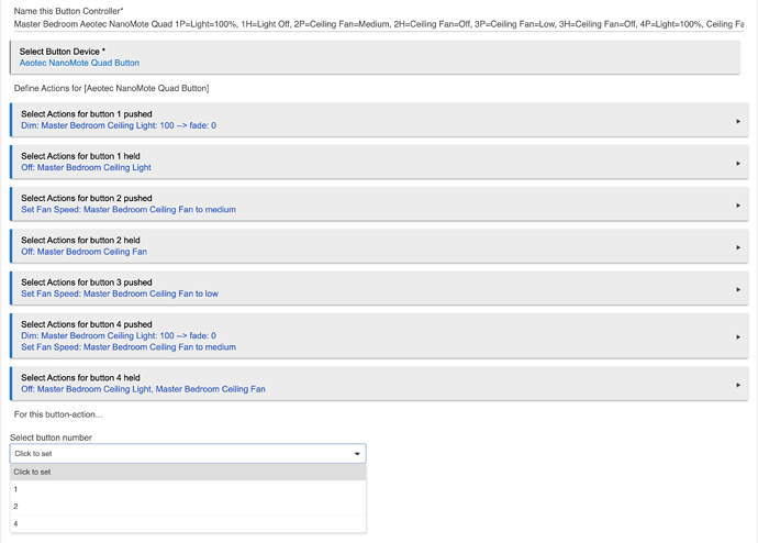

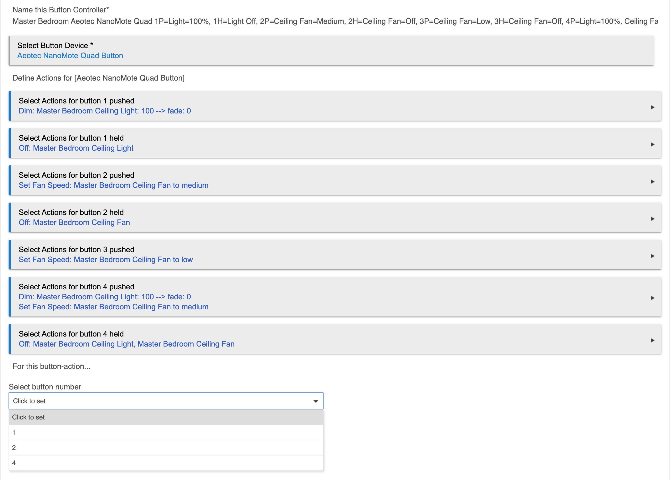

I was changing a Button Controller rule for an Aeotec NanoMote Quad. When I went to add the 3 Held nothing appeared. Likewise when I tried to create the 3 released. As you'll see from the screen shot neither is listed in my rule. Also, from the dropdown button 3 isn't listed at all because Hubitat thinks I've already defined rules for 3 Held and 3 Released.

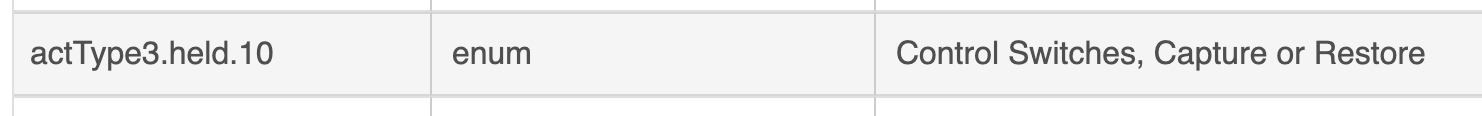

What's worse, is that 3 Held was originally controlling devices in another room and you'll see from the other screen shot it thinks it still is.
It would be a pain to have to delete this and recreate it, but is there any thing else I can possibly do?
Restore a backup that works.
Thanks. I didn't think there was anything less drastic than that. Seems it would be safer and faster to just redo the rule. This is a bug that I have seen time to time in other rule apps too (where you pick to add a button push/hold/release and it doesn't appear but Hubitat treats it like it did).
Hope they can track down and fix it.

Either toggling or disabling “Keep buttons sorted” will sometimes “fix” the rule.
I tried that several times, and even going out and then back into the app after doing a toggle, but it didn't help. I ended up just deleting it and making a new rule to do it.
