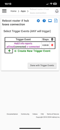

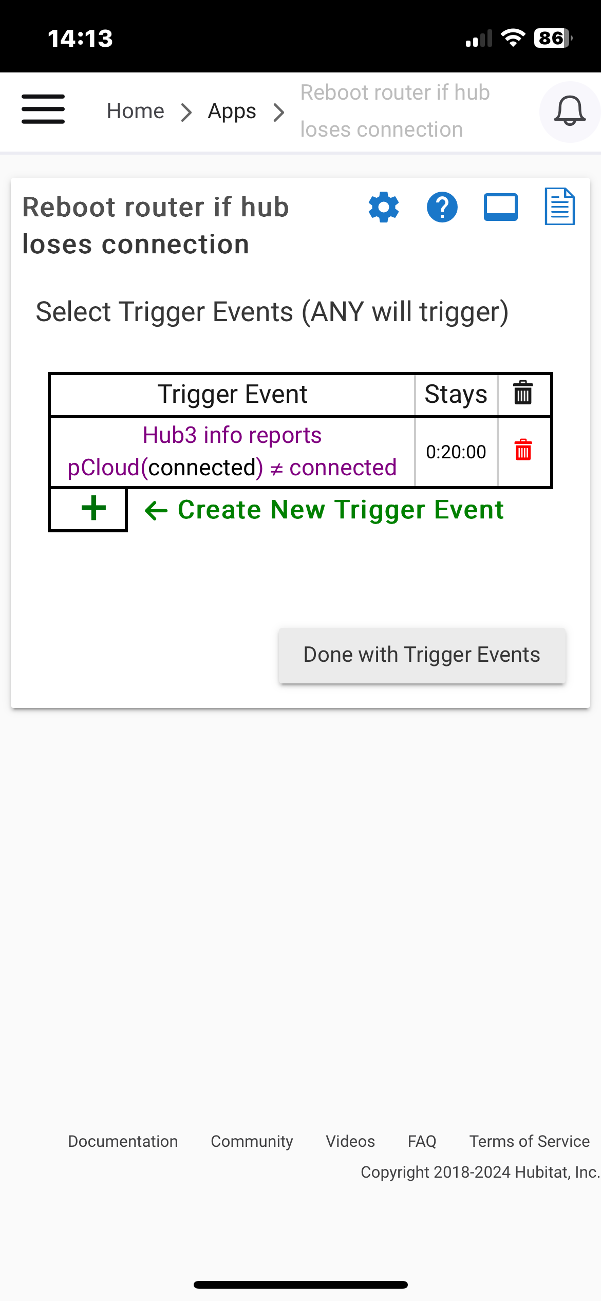

I think this is pretty simple:
You have to download and install @thebearmay ’s excellent Hubinfo driver, but I would think that this would do the job (although I haven’t tried it because my internet has only gone down once or twice in the past 4 years.
Use @thebearmay 's ping utility. Set it to ping 1.1.1.1 or 8.8.8.8 or any other address every 20 mins. On 3 consectutive failures have hubitat power cycle that outlet. Repeat as needed.
