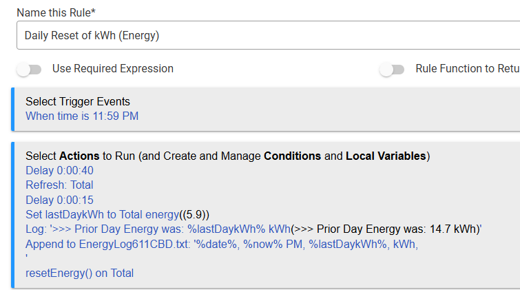

I have an energy log file (text file) in Hubitat that gets a new record at 11:59:55 each day with the energy usage for that day, date and time (see below). I formatted the new record with comma delimiters in my rule (RM) for later csv parsing. I just upload it to my PC and import it to excel as a csv file. Not completely seamless but easy enough for me.
This is the Energy Log File first created on 6/04/2026
2026-06-04, 11:59 PM, 43.5, kWh,
2026-06-05, 11:59 PM, 41.1, kWh,
2026-06-06, 11:59 PM, 59.4, kWh,
2026-06-07, 11:59 PM, 48.4, kWh,
2026-06-08, 11:59 PM, 46.9, kWh,
2026-06-09, 11:59 PM, 67.2, kWh,
2026-06-10, 11:59 PM, 64.1, kWh,
2026-06-11, 11:59 PM, 39.6, kWh,
2026-06-12, 11:59 PM, 44.7, kWh,
2026-06-13, 11:59 PM, 46.9, kWh,
2026-06-14, 11:59 PM, 25.8, kWh,
2026-06-15, 11:59 PM, 27.1, kWh,
2026-06-16, 11:59 PM, 22.6, kWh,
2026-06-17, 11:59 PM, 25.8, kWh,
