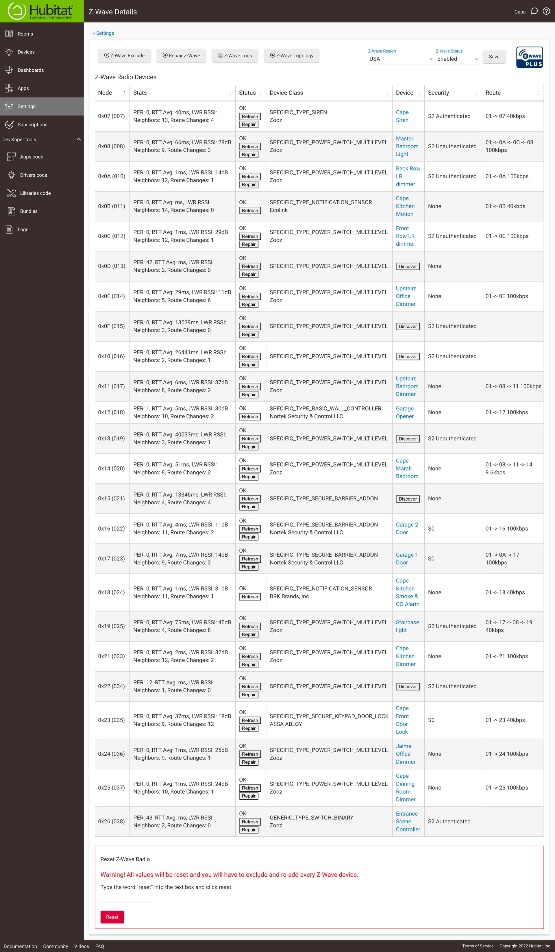

Here is my z-wave status. Device 26 0E 0D 0F 10 13 22 15 fail repair.
0x26, the Zooz ZEN32 controller seems to be totally down.
0E 0D 0F 10 13 22 15 are unknown devices in there and I am not sure are really attached to real devices I have around. I haven't removed any Z-wave devices from the house, I don't think.
Besides the two garage door openers, all of the z-wave devices (mostly Zooz switches) are in 2000 sqft split over two floors.
I tried to create a virtual scene controller and assign my Zooz Z32 automation to it but I don't see a scene controller virtual device.
Everything with the "Discover" button looks like a ghost device to me. Those will wreak havoc on a mesh. The problem is that you need to power off the real device to get them to clear, most likely. Worst case you'll need a z-wave stick to remove them using the PC Controller software.
For example, device 0x13 looks like a ghost (failed pairing) of device 0x14. You can try doing a refresh of 0x13, and then click the "remove" button when it shows up. If either fails, kill power to 0x14 and try again.
Yes, I was able to remove one or two that way but not most. I ordered a Zooz stick to further remove them
