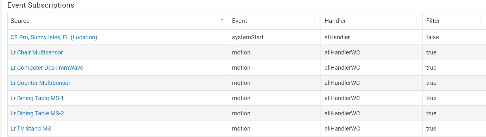

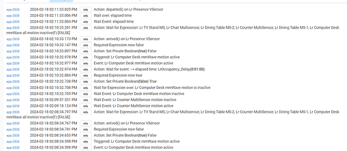

And here is one more failing rule (I have never seen before anything like this).

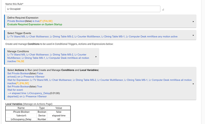

Here is a rule:

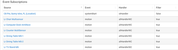

Here is an event subscription related to the latest failed run:

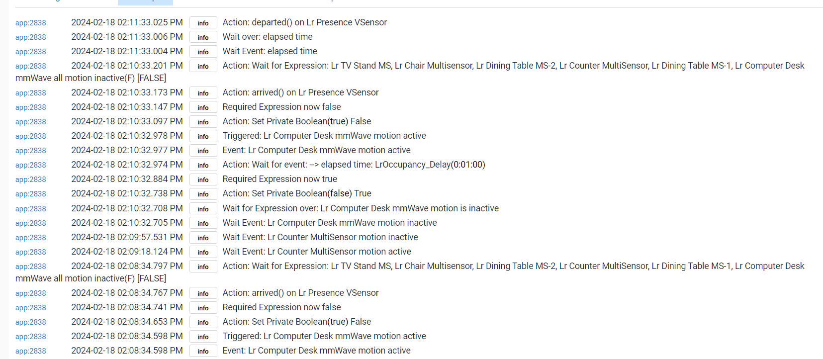

And here is a log:
Timer was started:
but at this time another trigger event re-triggered a rule:
and Wait for Expression did not wait for any events.
Now previously started 1 min timer expired
And the result is:
Action "Set Private Boolean True" is entirely missing.

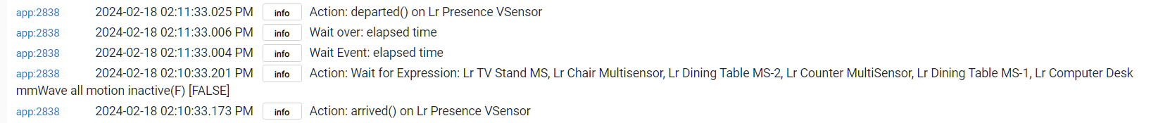

It looks like 3 lines in the log on top simply belongs to the end of previous trigger.
This looks like is an evidence of a race conditions. I.e. re-triggered run interfered with previous running instance. And because Private Boolean was not reset to True this rule is now dead because it cannot be re-triggered. I think, if triggering was not blocked the rule could potentially self heal on a next trigger.
What it looks like to me is that the Wait for Elapsed Time was not cancelled by the new trigger. I'll look into that. Why isn't the set PB true that last action instead of before that wait?
There are two instances executing at the same time, but that Wait for Elapsed should have been cancelled by the trigger.
You can toggle PB in the UI for the rule.
A simple test of Wait for Elapsed Time is cancelled by a new Trigger. Adding in the Required Expression for PB, like yours, yields the same result -- namely that the Wait for Elapsed Time is cancelled by the new trigger.
However, in your case, this is undoubtedly a race condition, since your Wait for Elapsed Time and the new Trigger happen 4 milliseconds apart. The hub doesn't have that tight a timing for reading and writing state, which it would have to do since you have two instances of the rule running. The easy fix for this is to move your setting PB true to the end of the rule, where it belongs. Otherwise, no sure way to escape the race condition.
What you experienced is to be expected given what you have going on with that rule.
Well done on finding a 4 msec race condition ![]()
The idea is to prevent re-triggering from multiple devices (motion sensors in this case) while any is still active but to enable re-triggering as sone as all of them becomes inactive. If I move PB resetting to the end the rule will certainly finish but Presence will be reset as well. This will be undesired behavior. I guess, I can split this rule into two rules in order to filter out undesired Presence Status flickering.

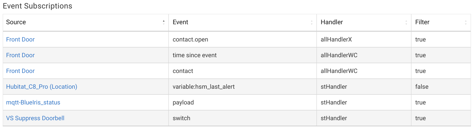

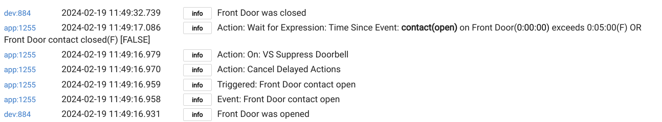

I hate to re-rail (is that a word?) this thread, but I think I caught a 'wait for' failure that ISN'T a race condition.

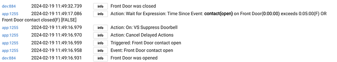

Here are the logs:
Here are the subscriptions:
I'll screen shot the rest of the application status page but only post it if more is needed.
To summarize my issue again, the rule is waiting for one of two things to happen... the front door closes or 5 minutes elapses since it was opened. The front door closes about 15 seconds after this wait begins, but the rule doesn't proceed at that point nor does it proceed after 5 minutes.
It is 12:01 as I write this, and the rule hasn't logged anything since the screenshot above.
