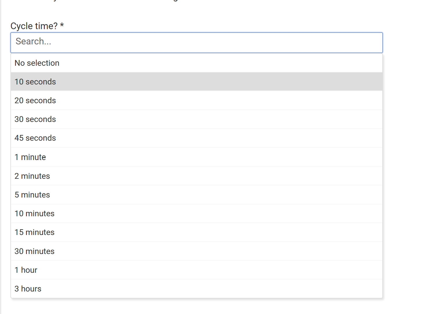

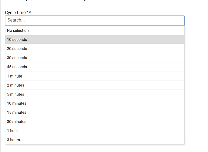

Another option is Garden Hue (Hubitat package manager)
Time
and Colors
I’m sure @kahn-hubitat Could add a sixth color, but this seems it might be easier for you. I use it to cycle colors during holidays but easily settable for daily.

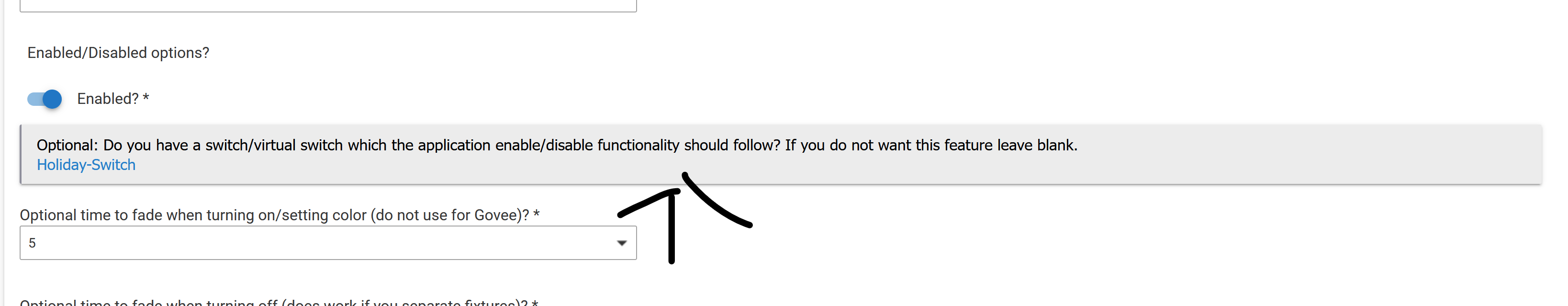

I use a virtual switch so I can set the activator to be any time.

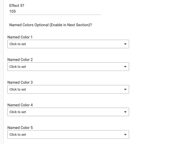

What’s those colous 101 etc all about?
Sorry, effects not colours
That’s specific to govee lights
Both Govee matter and zigbee?
yes
