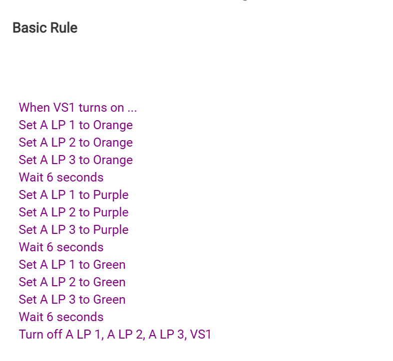

This is my basic testing screenshot but there was another cycle that changed it to white, the 6 second times are to save me waiting 15 or 30 minutes checking the cycle, now when the white section was in it no matter where it was inserted it changed to the insipid pink
It would be helpful if, as suggested above, you could show specifically how the problem can be reproduced, as that is the crux of the issue. But at least we know it's a Basic Rule. :slight_smile:
So, I'm going to make some guesses. If you're trying to set a RGB+CT bub to white, you should use "Set Color Temperature" (and some color temperature/Kelvin value you want, maybe 2700 or 3000 for a warm white or 4000 or 5000 for something cooler). Were you using "Set Color" instead?
Yes, I've just changed and it now works
