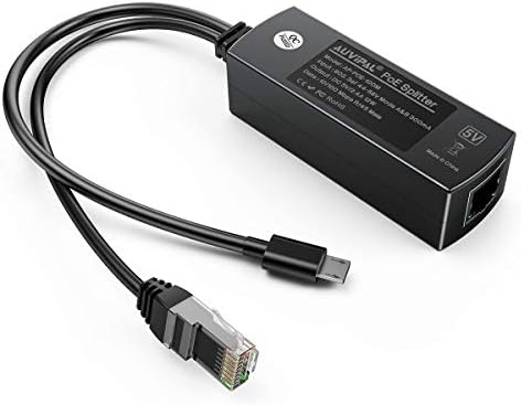

Is there a poe adapter we can use ?
You mean to power the Hub?
I think this has been mentioned before. I seem to recall someone talking about using a POE adapter to power a C5, but I'd have to do some digging. Are you thinking of being able to power cycle it from something like a Ubiquiti switch by turning off the POE?

https://www.amazon.com/gp/product/B075CQRX2H
2A would be cutting it close, depending on which model of Hubitat hub you are using.
FWIW my C4 is rock solid with this PoE adapter. The C5 claims to only require 1A, and is microUSB so there are other options there.
I have the C5 model. WIll this be a problem since it's 2amp and the c5 is a 1amp ?
Shouldn't be. More amps on the supply side is a good thing.
I've never metered a C5 to see what true peak amp usage is. But if the supplied power adapter is 1 amp (?) then anything above that should be fine.

Maybe I run a network cable from my basement to my main floor and power this over POE. At least I get the advantage of my UPS that's hooked up to my switch, and possibly better coverage of the house since it would be on the main floor......
+1 for this. If your switch is 'managed' then you can also remote into it to power cycle the hub.
