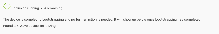

I have read a lot about August locks being unreliable and lots of problems.. Just moved from my OG Hubitat hub to the C7 and cannot get it to "sync" with Z-Wave... never had any of the issues most are having with the old hub... all the threads I read are about performance and reliability..
I've tried factory reset of the zwave of the lock and it still gives me a weird error of "z-wave found and bootstrapping" but never completes. Although the lockl thinks it's sync'd... I assume this is related to the other problems people are having but I can't even get that far haha

Keep trying to add it, I just got it to work. Make sure when adding it you do the secure method and leave both the dialogue boxes open until the lock is added. It took 10 min or so but the initializing part turned into a dialogue to name the device. I don't think we waited long enough.
