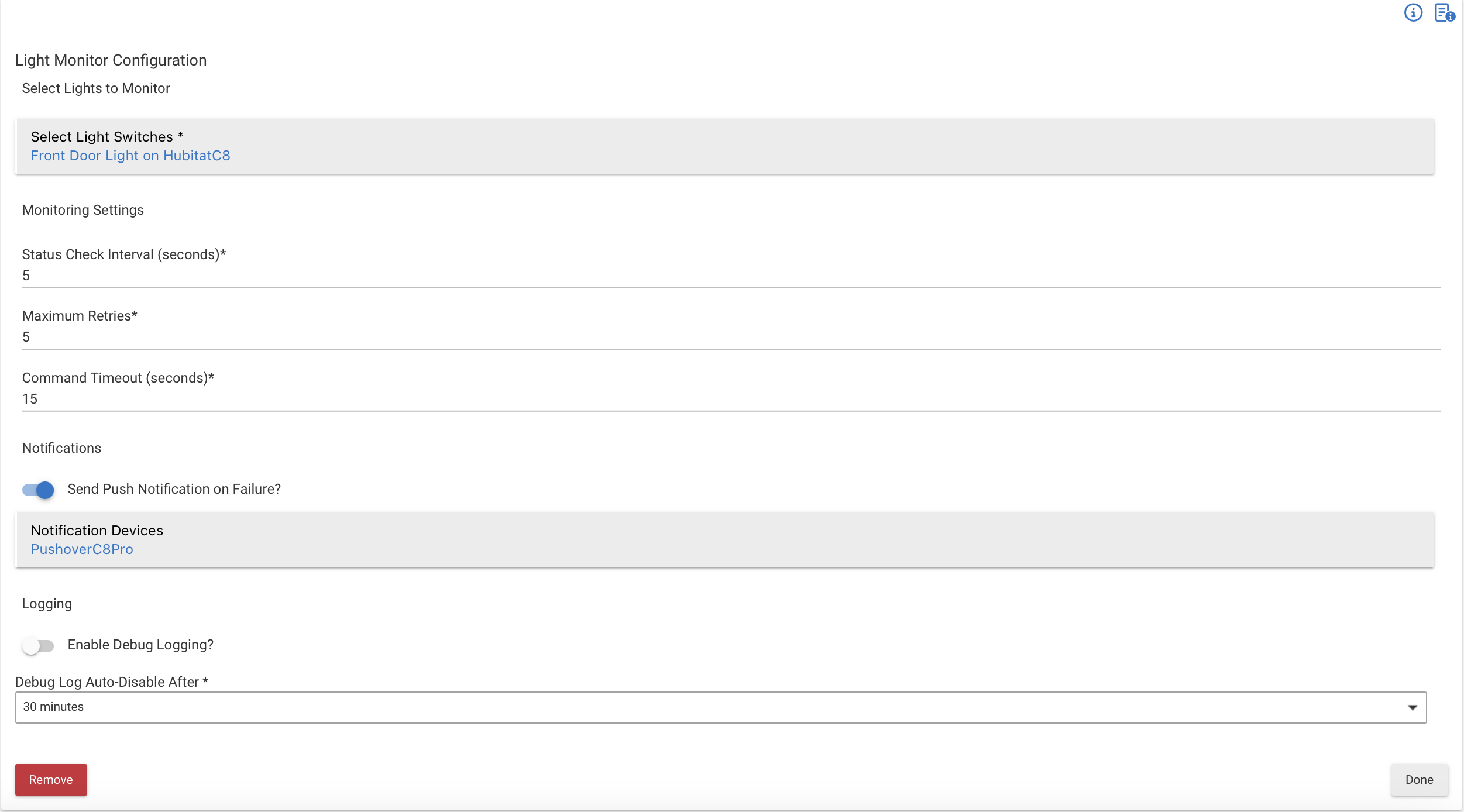

Another ai generated app - using Claude
I use Claude ai for other coding so I thought I would try it with Hubitat. I asked it to write me an app that would allow me to specify certain lights and have it monitor them. When they change status, to then follow-up and make sure they do as they are told. I have rules that monitor a number of old z-wave lights this way. FYI - Z-Wave Poller doesn't work for most of these switches). Here is what it came up with and it seems to work
I initially asked it for the basic functionality, then asked it to add in a pushover option when it failed and then a debug option.

preferences {
    page(name: "mainPage")
def mainPage() {
    dynamicPage(name: "mainPage", title: "Light Monitor Configuration", install: true, uninstall: true) {
        section("Select Lights to Monitor") {
            input "lightSwitches", "capability.switch", title: "Select Light Switches", multiple: true, required: true
        section("Monitoring Settings") {
            input "checkInterval", "number", title: "Status Check Interval (seconds)", defaultValue: 2, required: true
            input "maxRetries", "number", title: "Maximum Retries", defaultValue: 5, required: true
            input "commandTimeout", "number", title: "Command Timeout (seconds)", defaultValue: 15, required: true
        section("Notifications") {
            input "sendPushNotification", "bool", title: "Send Push Notification on Failure?", defaultValue: false
            input "notificationDevices", "capability.notification", title: "Notification Devices", multiple: true, required: false
        section("Logging") {
            input "debugMode", "bool", title: "Enable Debug Logging?", defaultValue: false
            input "debugDuration", "enum", title: "Debug Log Auto-Disable After",
                options: [[0:"Never"],[30:"30 minutes"],[60:"1 hour"],[120:"2 hours"],[180:"3 hours"],[360:"6 hours"],[720:"12 hours"],[1440:"24 hours"]],
                defaultValue: 30, required: true

                } else {
                    logDebug("Sending OFF command to device ${deviceName}")
                    device.off()
            } catch (Exception e) {
                logError("Error sending command to device ${deviceName}: ${e.message}")
            // Schedule next check
            logDebug("Scheduling next check for device ${deviceName} in ${checkInterval} seconds")
            runIn(checkInterval, "checkLightStatus", [data: [deviceId: deviceId]])
def timeoutCheck(data) {
    def deviceId = data.deviceId.toString()
    // Check if monitoring state still exists
    if (!state.monitoringState.containsKey(deviceId)) {
        logDebug("Timeout check - Device ${deviceId} is no longer being monitored, likely completed successfully")
        return
    // Get device info from multiple sources for reliability
    def device = lightSwitches.find { it.id.toString() == deviceId }
    def monitorData = state.monitoringState[deviceId]
    def deviceName = monitorData.deviceName ?: "Unknown Device"
    // If not found in primary list, try other methods
    if (!device) {
        logDebug("Timeout check: Device ${deviceId} not found in primary list, checking alternative sources")
        def allDevices = getChildDevices()
        device = allDevices.find { it.id.toString() == deviceId }
        if (!device && deviceName != "Unknown Device") {
            device = lightSwitches.find { it.displayName == deviceName }
    logDebug("Timeout check for device ${deviceName} - Desired state: ${monitorData.desiredState}, Check count: ${monitorData.checkCount}")
    // Check if we've had a recent check
    def timeSinceLastCheck = now() - monitorData.lastCheck
    logDebug("Time since last check: ${timeSinceLastCheck/1000} seconds")
    if (timeSinceLastCheck > (checkInterval * 1000 * 2)) {
        // We haven't checked recently, the monitoring might be stuck
        logWarn("MONITORING TIMEOUT - Light ${deviceName} command timed out after ${commandTimeout} seconds")
        logDebug("Monitoring appears stuck - last check was ${timeSinceLastCheck/1000} seconds ago")
        // Provide more detailed diagnostics
        if (device) {
            try {
                def finalState = device.currentValue("switch")
                logWarn("Final device state at timeout: ${finalState ?: 'Unknown'}")
                logError("Error getting final state for device ${deviceName}: ${e.message}")
        } else {
            logWarn("Device ${deviceName} not found at timeout check - Device may have been removed from Hubitat")
        if (sendPushNotification && notificationDevices) {
            logDebug("Sending timeout notification to ${notificationDevices.size()} devices")
            notificationDevices.each {
                it.deviceNotification("Light ${deviceName} command timed out while attempting to change to ${monitorData.desiredState} state")
        // Clean up monitoring state for this device
        logDebug("Removing monitoring state for device ${deviceName} due to timeout")
        state.monitoringState.remove(deviceId)
    } else {
        logDebug("Timeout check passed - device ${deviceName} is still being actively monitored")
