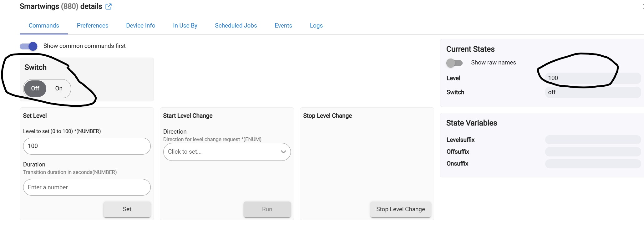

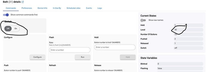

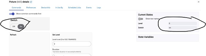

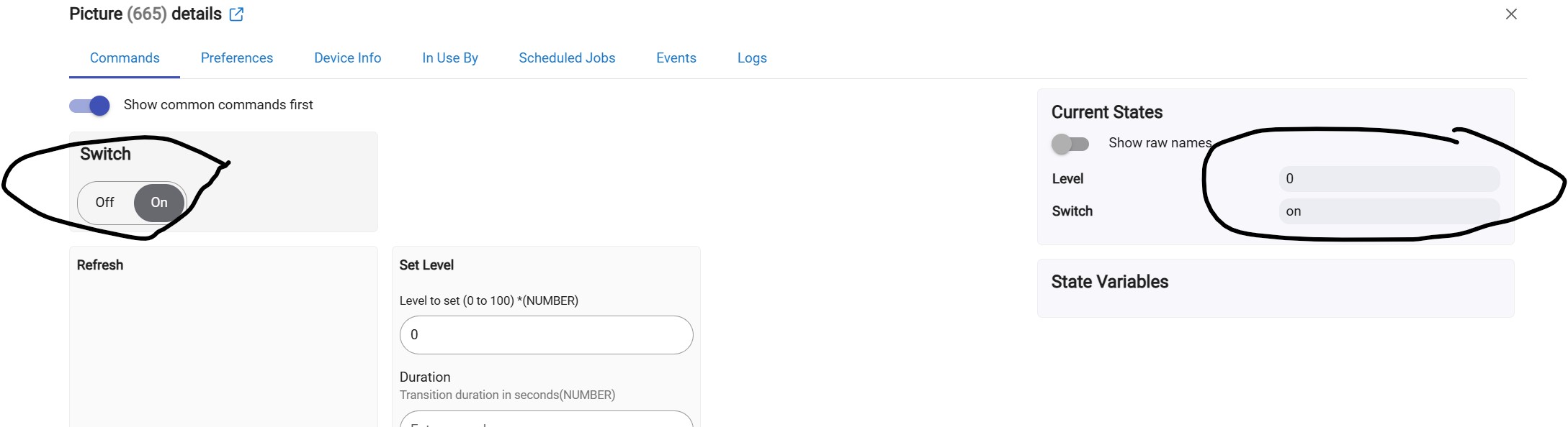

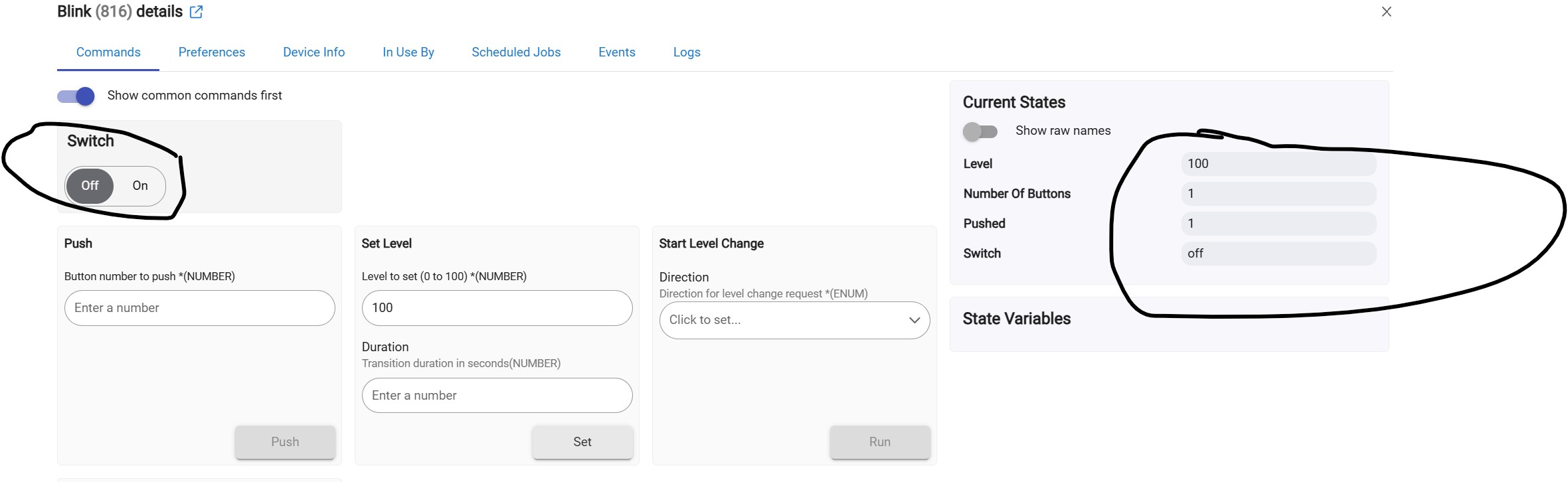

When I tell Alexa to set a dimmer to a number 1-99 the level updates and the change happens.
When I set it to 0 or 100 (shades all the way open or closed) the level value does not update. Only the ON/OFF status. Why?
That doesn't trigger the blinds. This seems like it should be so simple. OFF=0 - ON=100. Is there a work around for this? Can Hubitat coders change that?
It would also be kind of nice to be able to just say off or on for the blinds instead of saying a number...but that's just a minor issue.

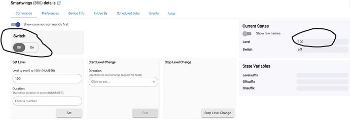

The dimmer "issue" is real...I may have fixed my immediate issue as I think Alexa was confused on the Groups and Scenes dimmer...I told Alexa the "Smartwings" was a light dimmer and she acknowledged it. Now the blinds respond.
The value does not update still for this dimmer or others as well. I am using the custom Smartwings app found on HPM. The built in did not work for me. PS - Blinds are Zigbee. I have not done a ton of looking at all the dimmer types...but this behavior seems to be universal for all of them. I have no idea why it's throwing some errors. I just installed them yesterday.

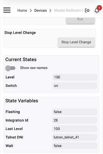

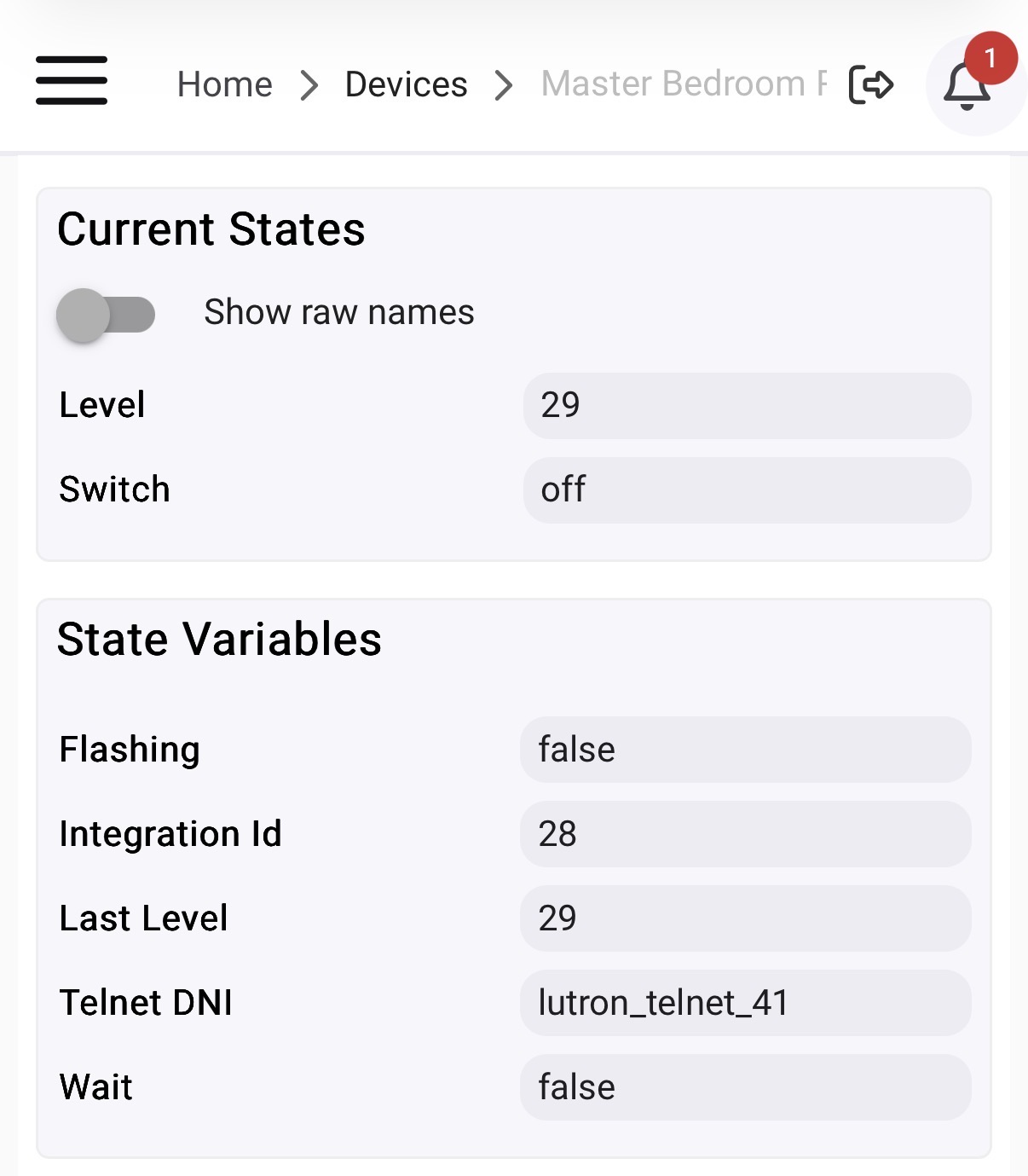

For example, here’s one of my Lutron dimmers.
Notice that it’s off, and the last dim level was 29%. Now here it is after an “on” command. No change to the dim level by me, just “on.”
It turned on to 100%. Because that’s the default behavior for this device and its driver.

The core cause may be that the Driver actual instantiation does not have the capability Window Shade commands. Looking at the code, the developer calls the capability; however, the commands do not appear in the instantiation. For this physical device model, the capability Switch and capability Switch level are coded to cause the off command - not supported by the device.
If window shade were the only capability, then the capability commands may properly control the device.

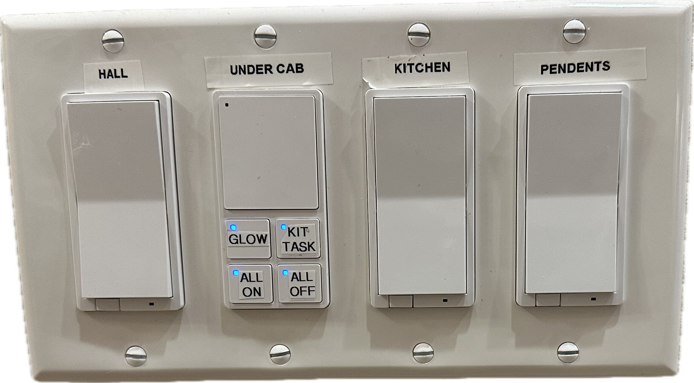

I have that exact scenario. I have a scheduled scene called evening glow that sets several dimmers to 25%. I have a ZEN32 with a button labeled Kit Task. When pressed it turns a couple of dimmers in kitchen work area to 100%. If you double tap the same button the lights return to prior setting.
