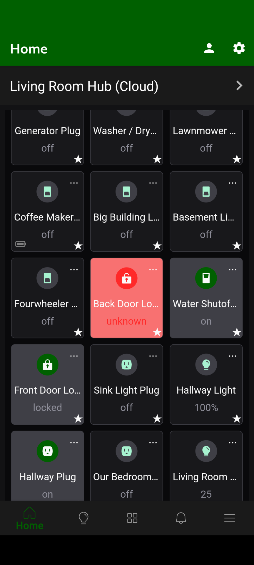

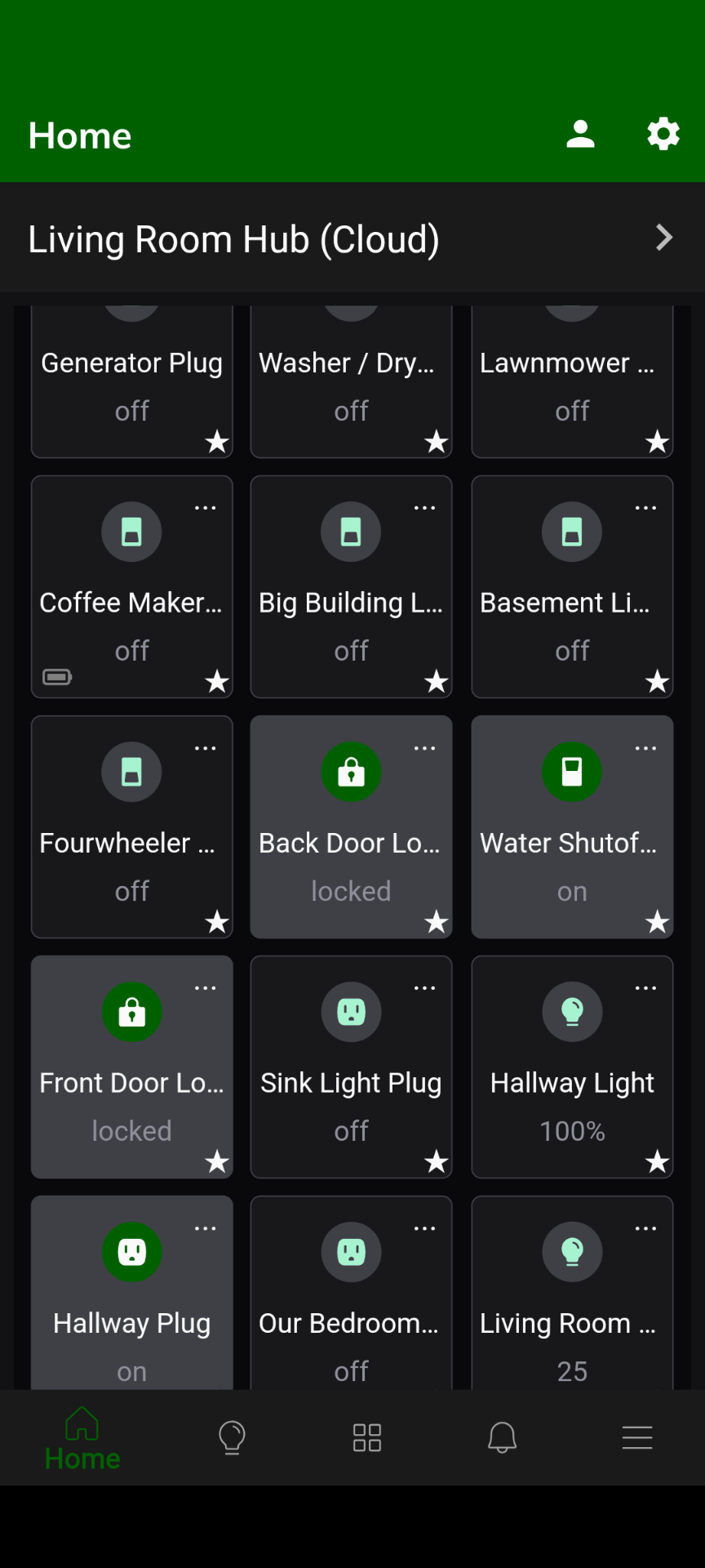

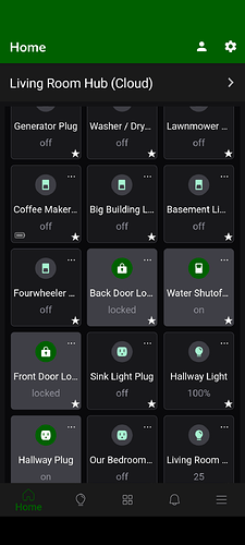

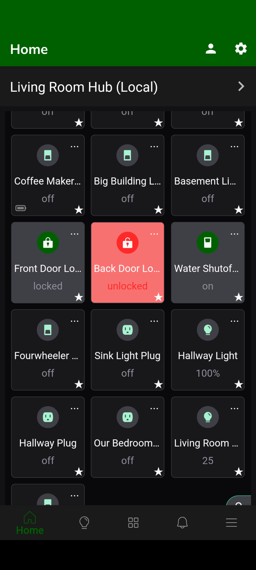

(1). I use the Aqara U100 locks. Since Hubitat doesn't support matter locks at this time I bring them into HA via matter from an Aqara Hub. Then bring it into HE via the HADB. What I have found is on both LAN and Cloud when the locks are locked they show and state locked. However, when unlocked when on LAN they state unlocked and the button is red but when connected via cloud the button turns red but the text reads unknown instead of unlocked. I have screenshots to help explain.

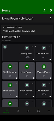

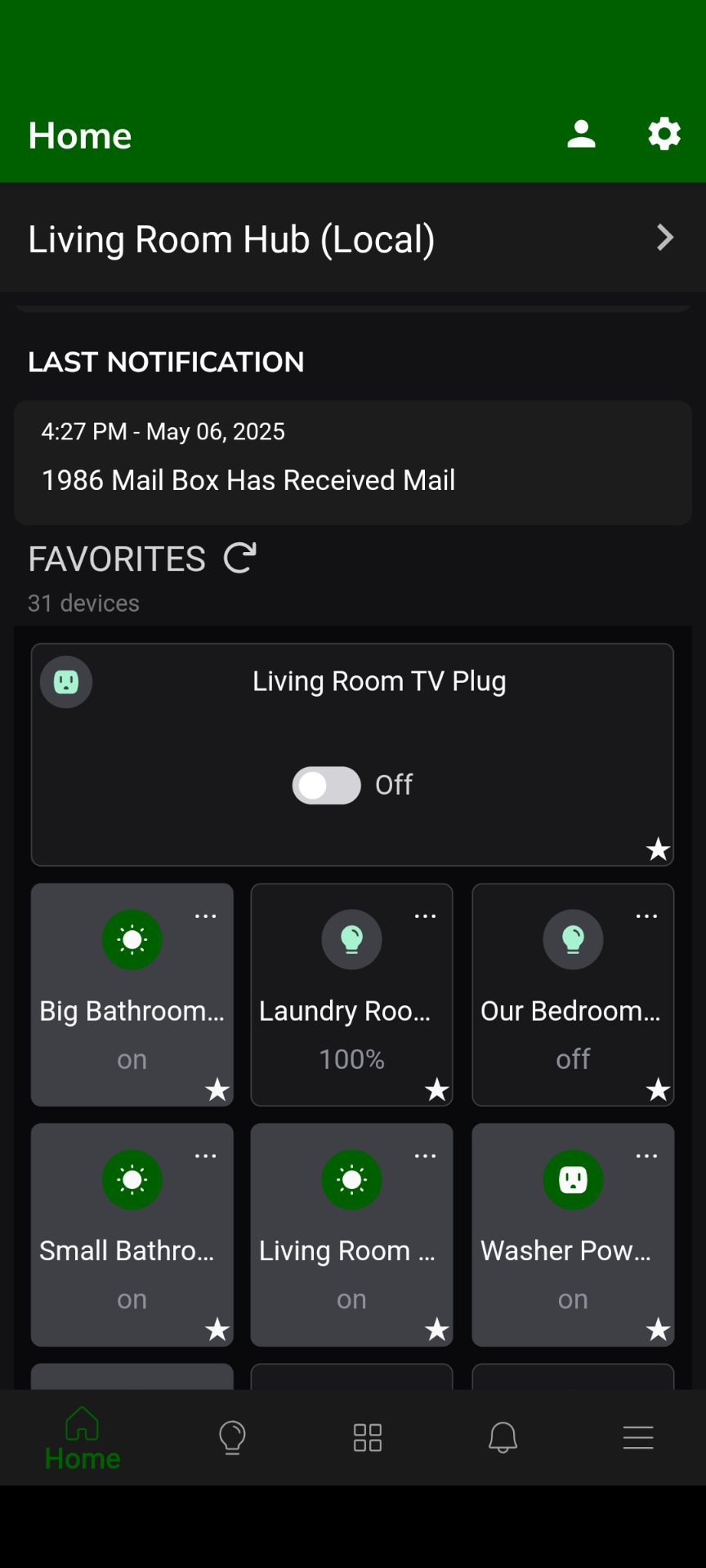

(2). The buttons on the favorite screens will just move. Sometimes some will disappear and they will shift up until you refresh the screen. Also. When trying to adjust there location a tap of the arrow may move one spot or three spots. No rhyme or reason it seems. Also, if you adjust the tile size to 3 x 1 after a little bit the tiles below that will shift up and cover it. I have screenshots of that as well.
(3). I think I saw a version of this on another thread but if you adjust the tile size to a fixed 2 x 2 row format then the favorites screen will not let you scroll down to see all of them. The problem is if you don't adjust them you can't accurately read the names of the devices.
