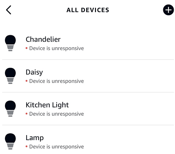

my alexa app shows everything "Device is unresponsive" again.
while apple Home through HomeBridge worked perfectly.
