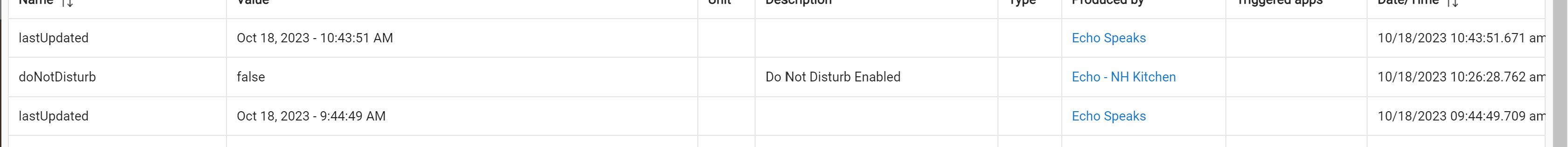

cannot figure this out.. 2nd morning in a row.. it doesnt appear to be coming from the hubitat but i did change to using echo speaks from the old alexa tts a few days ago.. so this is suspect..
you can see the speaker did notice that do not disturb turned off at that time..

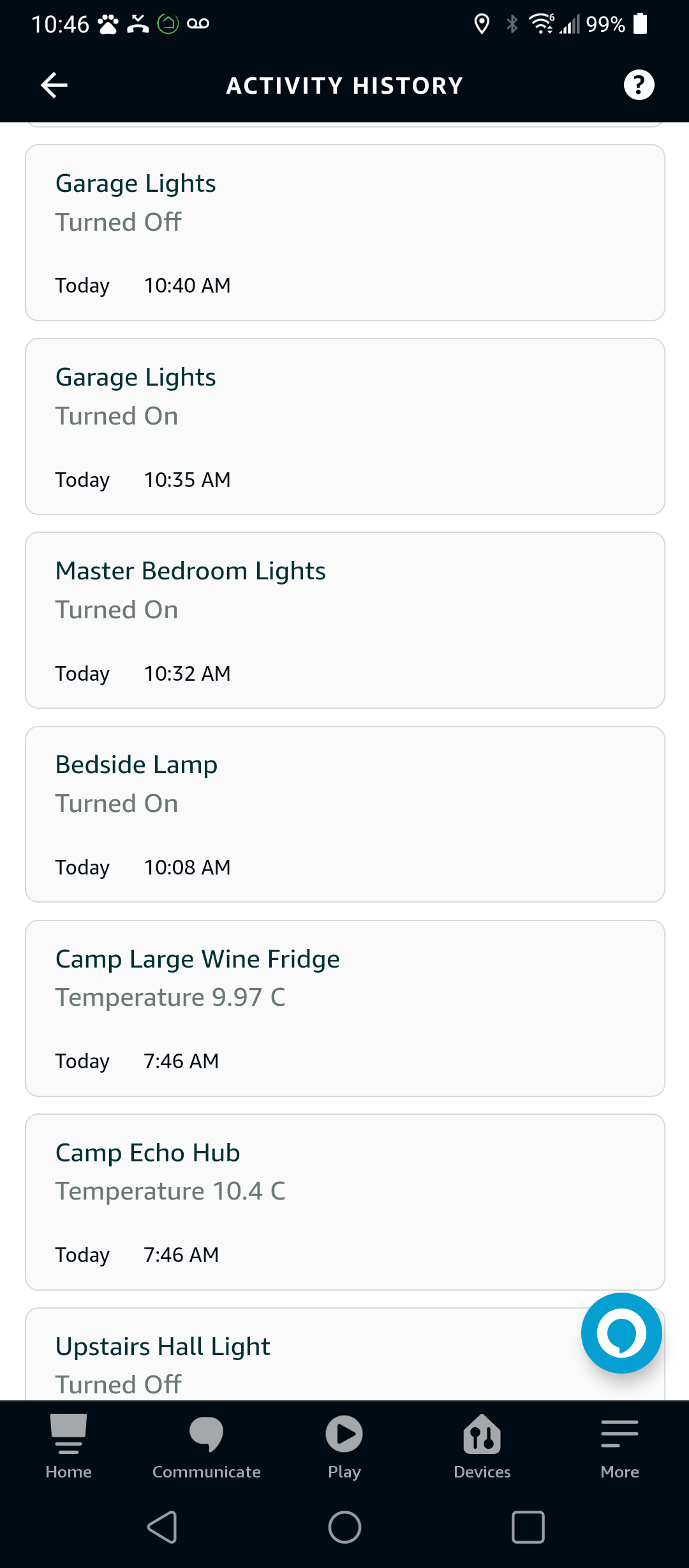

also nothing showing as happening in the alexa app

but if it was something i did in hubitat it would show in the device logs that spoke.. it.. nothing.. and i never had any other home automation systems.. very weird..
as for the same time not sure.. i think it was earlier yesterday.. i will keep further track of it.. today was at 10:26

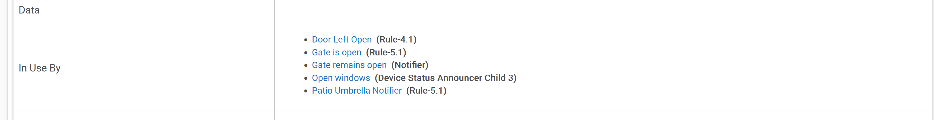

Look at the inuse by and check all of those rules
again if it was coming from hubitat the device would show as follows from events.. and there is no such entry so dont belive it is from hubitat so checking rules would be fruitless

just a few routines directly in the alexa app, but again nothing like this and as shown above the alexa is not showing any activity at that time as well.

I mean the IN USE BY at the bottom of each echo device page... Just something to double check is all
I know nothingg relevant and i checked in both hubs
same today.. all devices at 10:36
i had logging open from both my hubs at the time.. nothing relavent.. and again nothing in alexa app smart home activity
