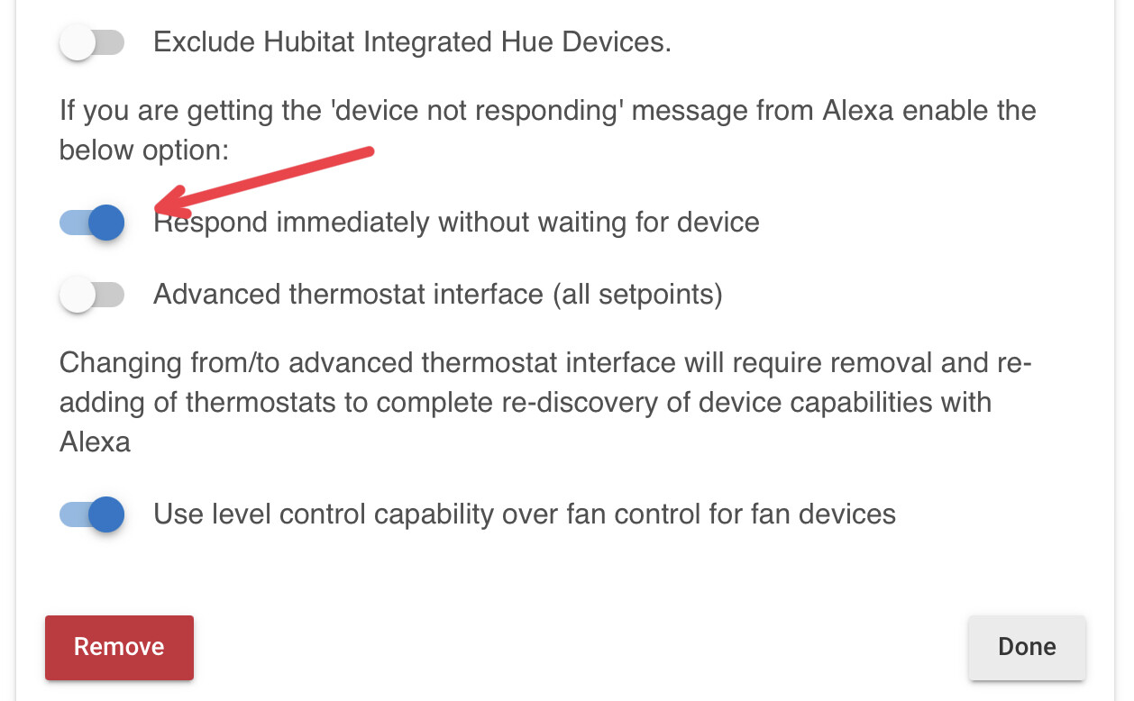

@ksorensen, there is an option in the Alexa integration that, as I understand, was added to resolve the issue you mention in your point 1. Above:
If you haven’t tried this yet, give it a go to see if it works.

Thanks for the tip; however, before it was taking Alexa a minute or so to say the device was not responding, Now, she responds immediately and says "I'm not sure what went wrong." But the fan did turn off/on. Go figure.
