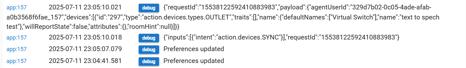

Hiya folks. Looking for a bit of guidance. I have a device that I cannot directly integrate with Hubitat and therefore I am trying to control it through the google interface using a virtual switch to trigger a google routine. I have the Google Home app installed and it appears to be working but when I trigger the switch nothing happens until I go into the home app and refresh the devices which defeats the object of the routine. After some research I believe this app may solve this issue by allowing me to push updates using the Homegraph API.
However I am struggling to get this app to function correctly.

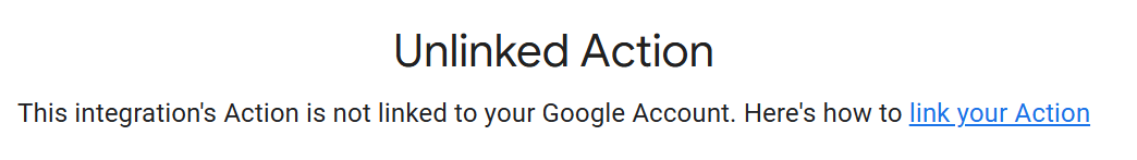

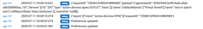

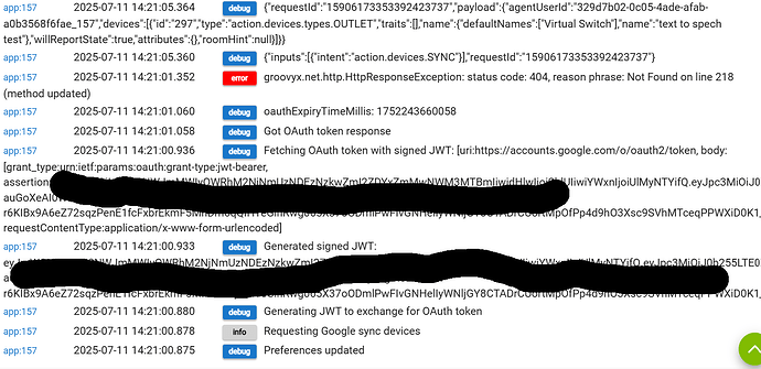

Following the guide I have created the project/integration etc but when I try to link the app I get the following error on the home app "Could not reach [test] integration. Please try again". The hubitat logs show the following at the same time:
The only issue I had following the guide is when i try to select the test it comes up with the following error message:
Can anyone point me in the right direction to get this resolved?
Try the "Push device events to Google" toggle and removing the service account authorization until you have the integration synced for the first time. The requests that the app sends to Google will fail until Google has seen your user for the first time.
Hi, Thanksfor the advice. So the push device events was enabled so tried in the disable state and still getting the same error.
I then went in and removed the JSON file conntents and retried but still getting the same error.
Finally I actually deleted the service account related to the integration within the developers console and retried but still getting the same error. However there are no longer any error message within hubitat (not sure if that provides any clues)
Thanks. Any more suggestions?
Oh, it appears you didn't define any traits for your device type. You need at least one trait (likely an On/Off trait for a switch).
Damn. I hate it when I miss something stupid. Sorted thanks.
