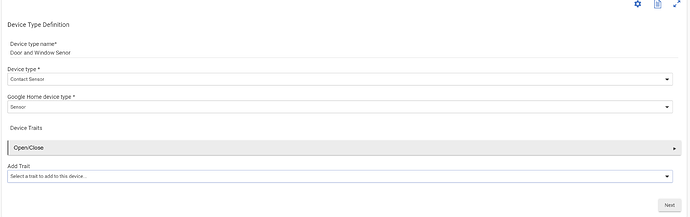

Hello am I setting this up correctly? The senor shows up in Google Home App but the Status never changes from closed when the door is open.
The open/closed attribute looks wrong. It should be one of the attributes listed under "Current States" on the device page. For a contact sensor that's probably contact.
Thank you. I been looking thru some old post, I'm assuming its still the case that Google Home only polls the status of devices once.
Google Home only polls a device once when you open it. If you follow the HomeGraph setup instructions and turn on the "push device events to google" toggle then the Hubitat app will tell Google when a device state changes and that should be reflected within a second or two if you have the device open in the Google Home app.
