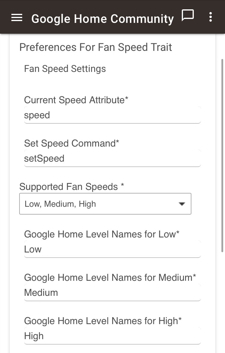

Has anyone managed to get this app to expose a fan with speed control to google home?
I have setup speed control in GHC but GH just shows an On and Off button for a fan. No speed control.
Traits appear to be setup. What am I doing wrong here?
