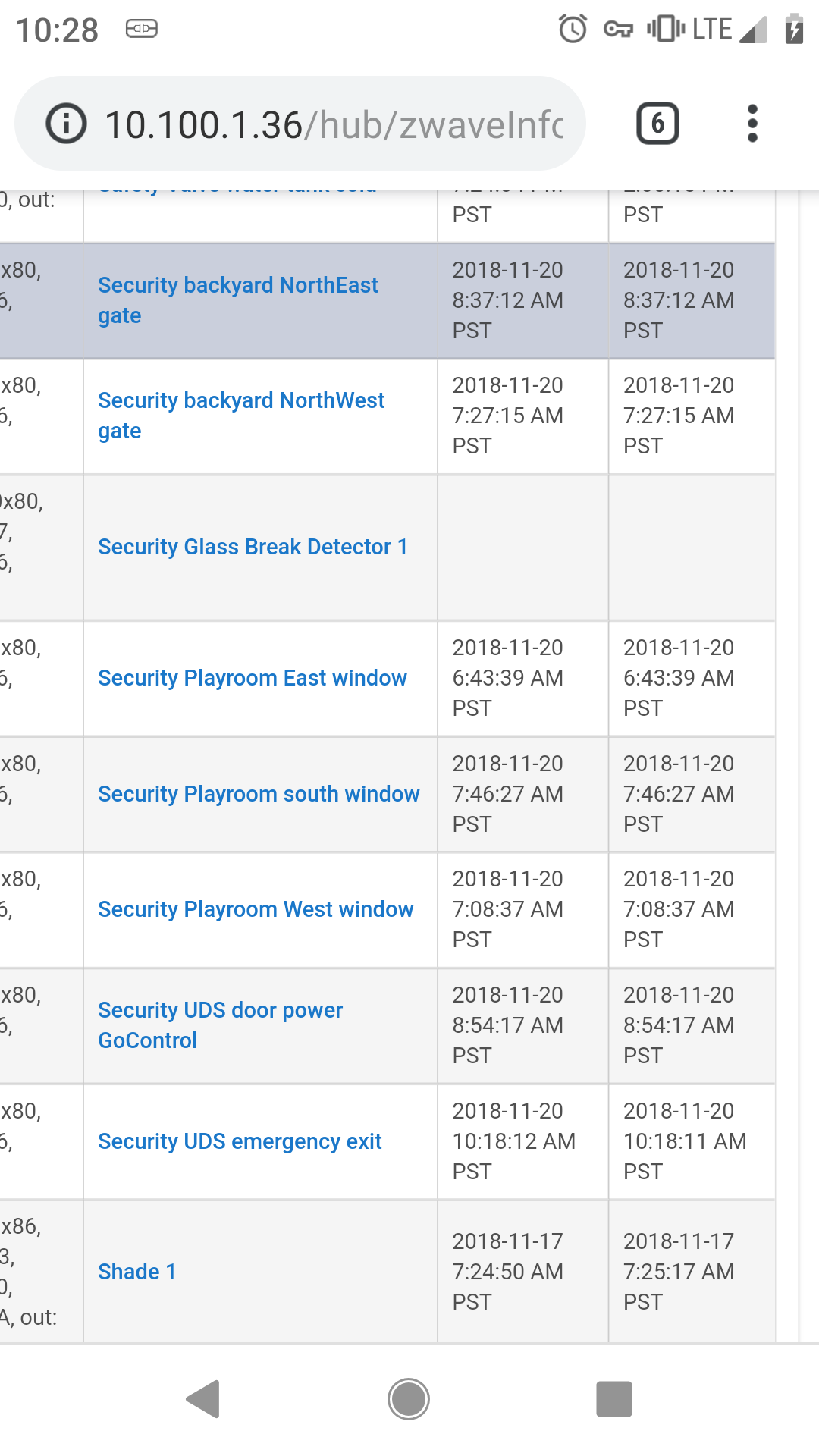

You can try remove the battery and reinstall back. Look in the Z-Wave info page and these sensors usually report back almost daily for battery status. That's how I usually check them. Also there could be a mesh issue so do a Z-Wave repair as well.
The picture below shows some ofy GoControl door sensors.
