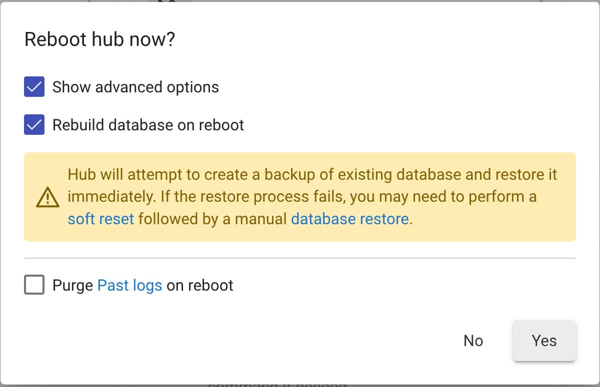

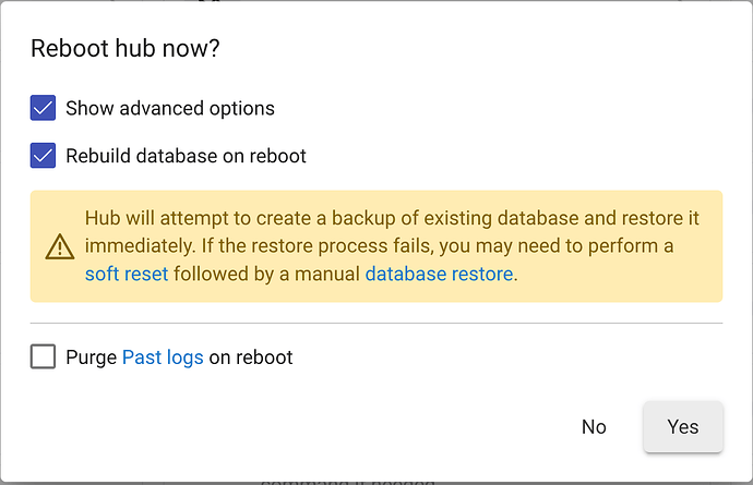

Have you tried a reboot with the advanced option selected to rebuild the DB upon reboot. To me this sounds like DB Corruption.
You might want to reconsider this. It is almost never necessary.
Assuming you have recent hub database backup (local or cloud). I would download all your local backups to your PC for safe keeping. Then, I would first try the suggested reboot with rebuild to see if that helps.
If that does not work I would do a soft reset from the diagnostics tool, and then restore ONLY the hub database from your latest backup before the incident. DO NOT RESTORE z-wave or ZigBee radios, those should be fine as-is.
