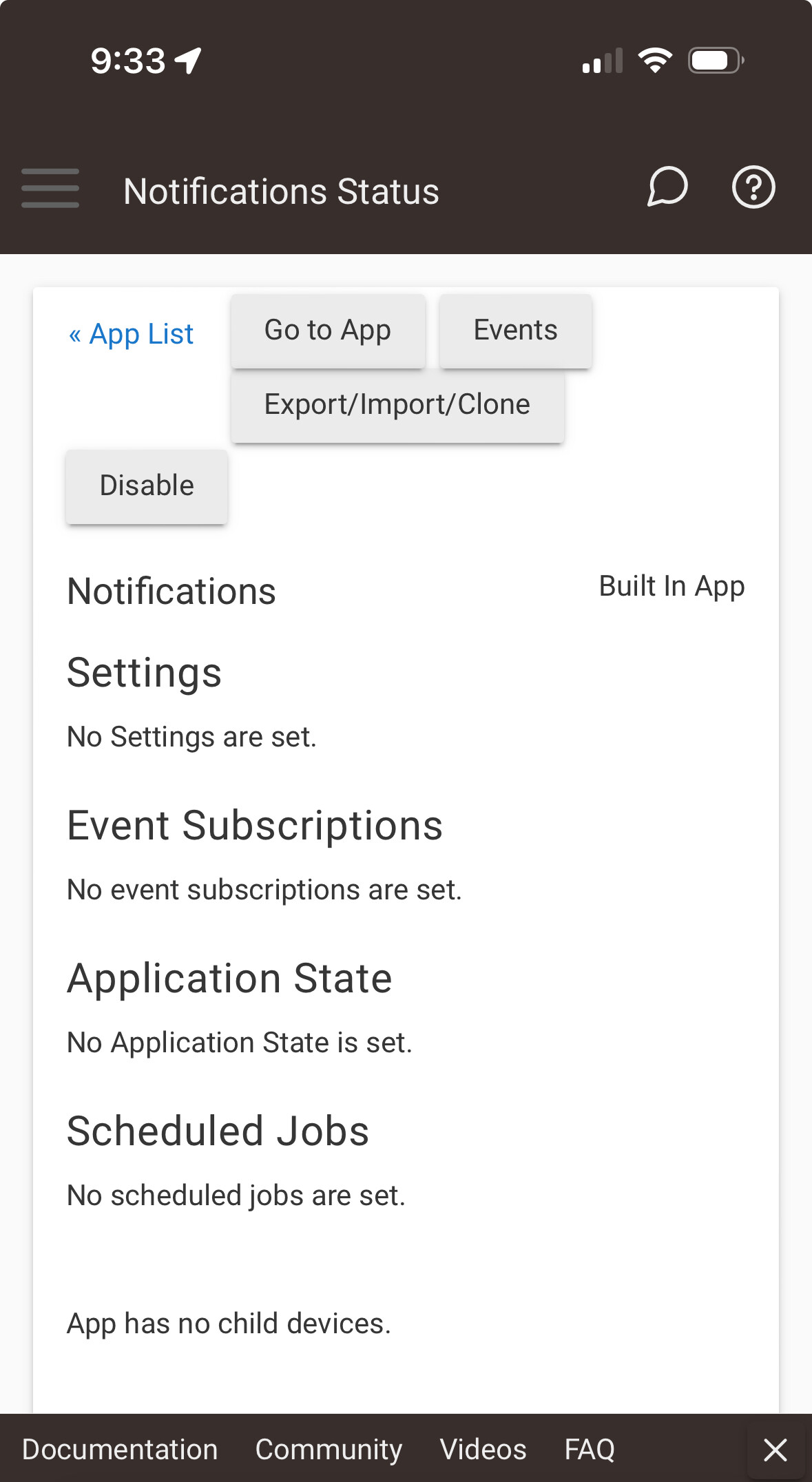

But how do I explain the built-in Notification showing no child processes when there are numerous children and the others appear to be working?
LJ
I’m not sure I follow your question.
The screenshot above says the notifications app has no child devices. That’s presumably true, since the notifications app doesn’t create child devices. Some apps do (but not that one).
If your devices are not reporting their battery status, the notification child apps configured for those devices won’t send any notifications. Just as the device watchdog won’t send any.
Ok, now I
Understand your point on “devices” there should be no devices. Child apps perhaps, but not devices. Let me fix the two device problems first and see where I end up.

Yes, child apps and child devices are distinct.
It does sound like the devices themselves are the probable source of the issue you’ve run into.
If you can sort out what’s going on with those two devices and their battery reporting, I think you’ll find that device watchdog and the Notification app will start working as expected again.
