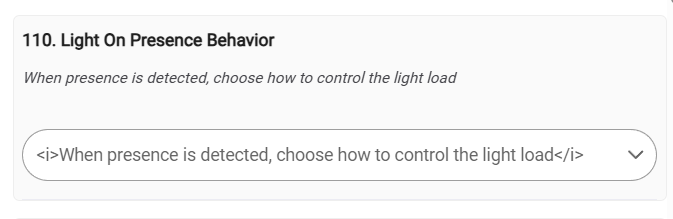

Well after getting though a rough setup process with the C-8 Pro and seeing all the configuration items that are in the Inovelli driver I was thinking to start a tread on how folks are configuring the device. Looking at the preference page for this device can be intimidating. But having options comes at learning what these settings can do.
In my case I am looking forward to attempt to configure the device as both lux and occupancy sensor but not controlling the switch directly with the mmWave sensor but leaving it up to the Hubitat to turn on any devices in the room when the mmWave sensor determines occupancy along with lux and house mode.
Haven't figured it out yet but the default is occupancy and the switch turns on. Need to find a way to disable this behavior and there are over 50 setting on the page to review. Now on to my studies.
Update Found the setting, number 110

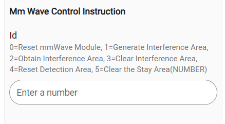

With so many features in the mmWave settings I am getting confused on how best to handle a occupancy when curtains that move when the HVAC are right behind the couch I want to use as the primary area for motion detection.
Inovelli's steps are well documented in their "Advanced mmWave" page but has anyone done this yet? Seems to require quite a bit a trial and error to set it up right.
I tried the automatic process and still can't seem to get my use case to work. I turn on the HVAC blower and then did a reset of the mmWave sensor and then Generate interference
Reduce your distance to stop a foot before the window coverings.
Thanks forgot to say that the couch and window blinds are to the right of the switch. So have to try moving the right side tigher to the switch and maybe the height to just below the backing of the couch.

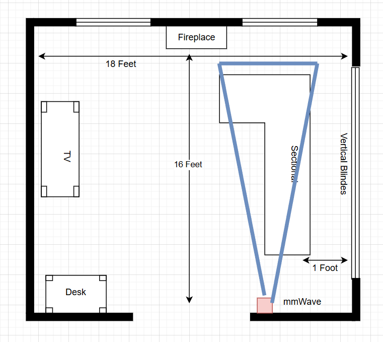

Trying to come up with occupancy detection for my family room and this is the shape of the area. I assume all the values that Inovelli references are in centimeters but not sure. I am trying to come up with the right values for th
From the Inovelli documentation table for default
Parameter Axis Description Default Range (cm)
101 Z-Axis ↓ Minimum height (floor boundary) -300 (-100*) -600 to 600
102 Z-Axis ↑ Maximum height (ceiling boundary) 300 (100*) -600 to 600
103 X-Axis ← Minimum width (left boundary) -600 -600 to 600
104 X-Axis → Maximum width (right boundary) 600 -600 to 600
105 Y-Axis ← Minimum depth (closest detection) 0 0 to 600
106 Y-Axis → Maximum depth (farthest detection) 600 0 to 600
I am thinking that this would be my paraters:
101- Keep Default
102- Keep Default
103- (-125)
104- (+60)
105- (0)
106- (480)
Just want to validate with the group or is there some better ways to map the room with some of the advanced features. Oh one thing is the vertical blinds move when the FAN is running on my HVAC.
