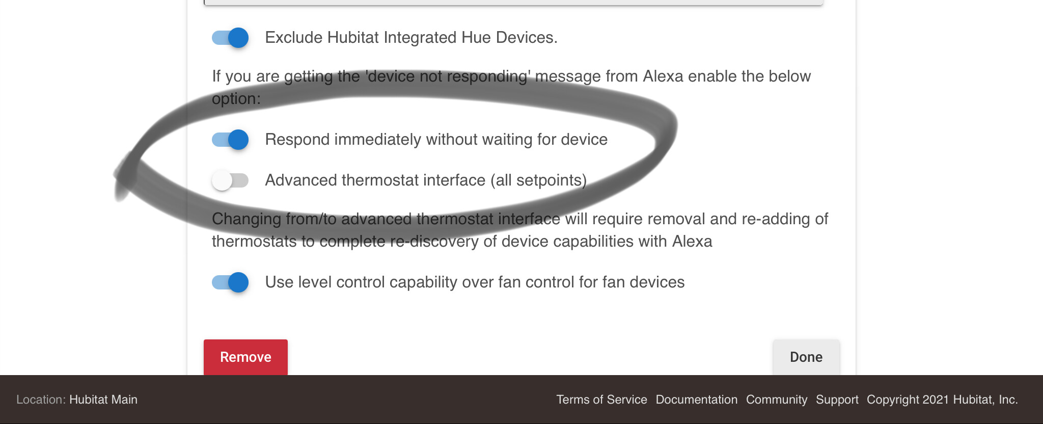

Do you have the Respond Immediately switch turned on?

ok. but if that's the case , why doesn't the " Respond Immediately switch" solve this ?
