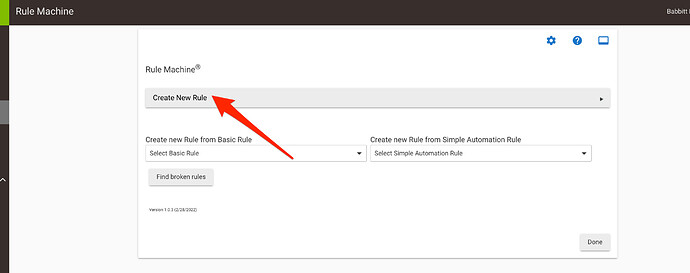

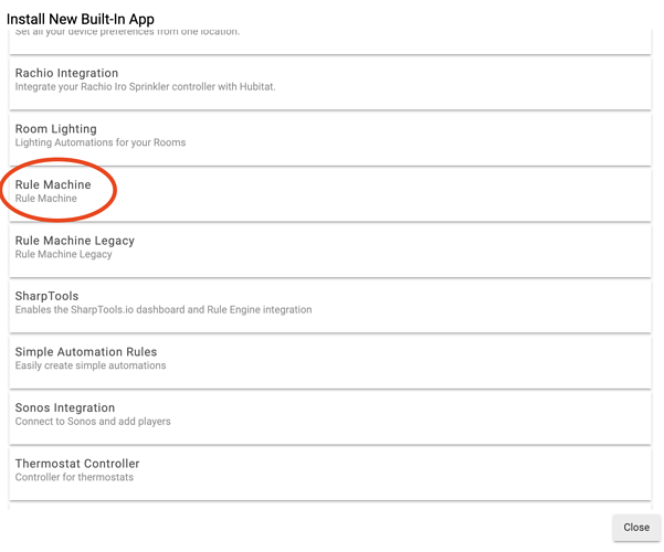

Apps code allows you to add third party (or your own) apps written in Groovy. What you want to do here is add it in Rule Machine. If Rule Machine doesn't show up in your listed apps you can install it by going to the apps page and then clicking here...
and scrolling down to
However... if this is your first attempt at automation you may want to try something a bit simpler. Rule Machine is powerful but it can be a bit daunting.
Sounds like you may be jumping in at the deep end of the pool, so to speak.
There's some documentation available here that will help.
https://docs.hubitat.com/index.php?title=Hubitat_Elevation_Documentation
I tried to add it to RM but can't locate where to enter the code.

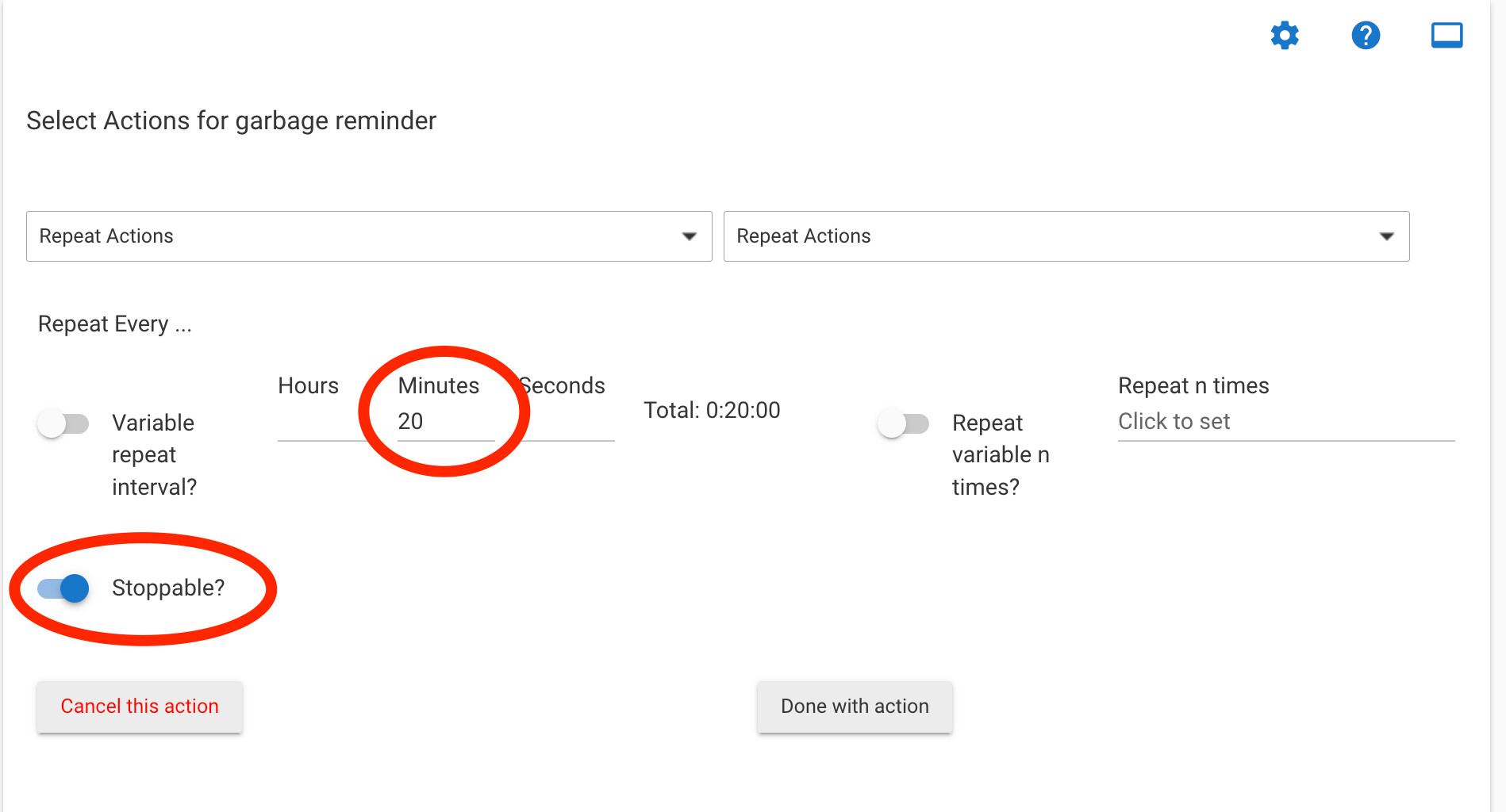

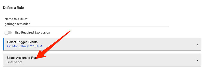

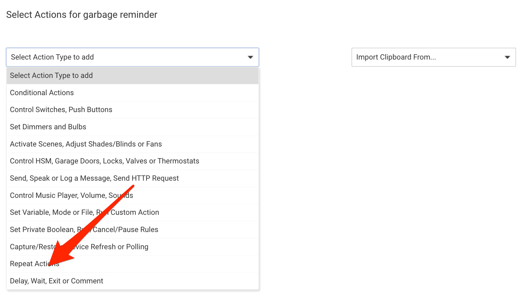

It's not so much a matter of typing in the code as it is selecting code elements from the drop-downs. The screen shots should give you an idea, though I did omit a couple intermediate screens to save time. Hope this helps! It is a little tricky at first so patience is key. Again, you might try with a much simpler automation and get the hang of it.
