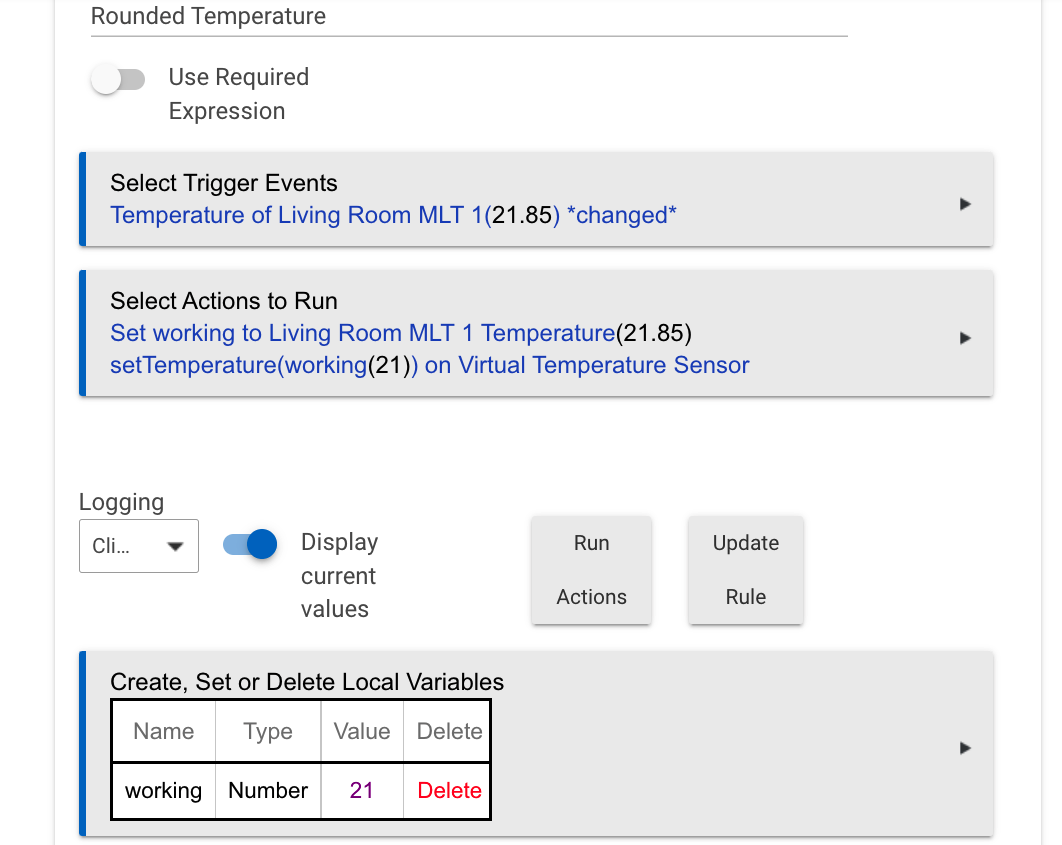

My solution would be.
And to share the virtual sensor to Alexa instead.

Thanks for a simple solution, it should work.
Uuuh, that would be perfect, just start looking in the code where I change it! Will check immediately! Thanks.
