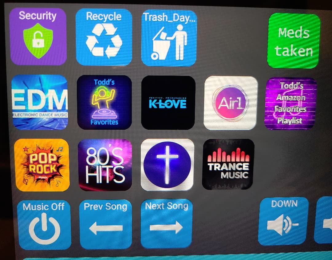

I cannot speak much on how to use RM with Echo Speaks. I don't use that method. And if you are not familiar with Webcore, then RM is probably the path to use. I can interact with Echo Speaks using voice (with Echo devices around my house), dashboards around the house, my phone, sensors around the house....you get the idea. For instance, I have various virtual switches on my pads around the house that control playing different types of music from my ceiling speakers. I have Alexa routines that mirror those virtual switches so that I can also use voice to control my music. Those switches/routines trigger webcore pistons to do the heavy lifting. For example, my Christian Hits button triggers a piston that uses Echo Speaks to send a command to the dedicated, muted echo to play "Amazon Christian Playlists." The muted echo is plugged into my AV system and that music source and speakers are activated in that particular location in my house to play that selected playlist. I am sure that someone here can explain how to do that with RM.

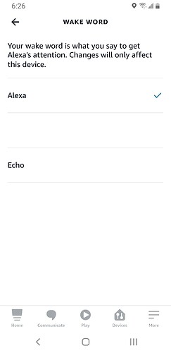

I use different wake words for Echo's in the same room sometimes. My wife's Bedside Echo is Alexa and mine is Echo. That might help with part of your plan.
@Hal3 And this is with using echo speaks, or just native echo rules/settings routines?
@all - I’ve had mentally a tough time figuring out efficiencies gained with echo speaks. I don’t need announcements for switches or my Rachio turning on or off. Where I see it could be good is to mute them all from listening to you, but you lose some of the benefits of asking questions, weather, etc.
I think I’ll mute my dot (physically on the device, didn’t see setting in the app) that is hooked to my overheads/amp. I’ll command music to be played from my mobile app or via voice from kitchen echo show. Sounds like I can just do that via echo groups/routines?
Appreciate your detail/patience!
Just the usual Echo settings to select a wake word.
