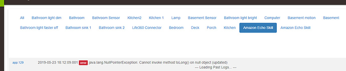

Alexa is controlling the devices but says the device is not responding after the latested update today. how do I fix?
I removed the Alexa app and installed the Alexa Skill and took care of this issue
Just tried that , still doesn't work. getting a null error in the amazon echo skill. this was working before the update.

So I have a workaround to fix this annoyance; unfortunately it requires having access to the SmartThings IDE (though probably not a currently active ST hub). Create an Alexa device group with the name of whatever Hubitat device Echo needs to control, and include within it the Hubitat device and a SmartThings virtual switch (whose only purpose is to mitigate this apparent issue)... no more 'not responding' message.
