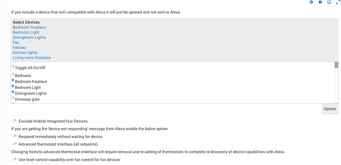

But I can't come up with any way to get Alexa to control my Bedroom Fireplace, shown as:
Note that my Alexa App is configured to enable both devices:
I think I'm missing something foundational as to how and what Alexa can work with? All pointers appreciated.
