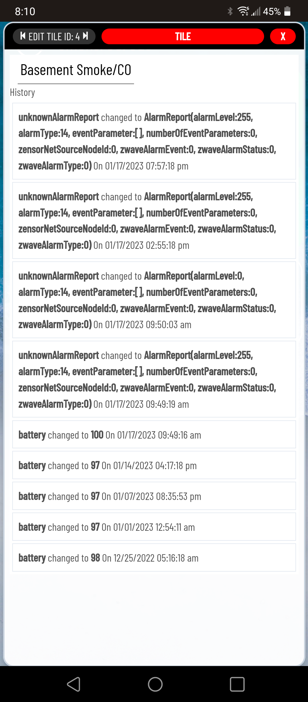

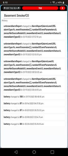

Alarm type 14 .. eol alert
Dual smoke co had a low battery . Was chirping.
Replaced it...still getting this message
Any idea what it means.
Think this may be the end of.life chirp and alarm

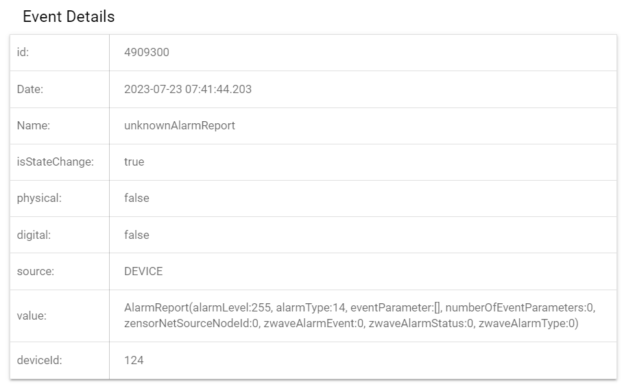

Well this is a first for me. First of all that command class is depreciated. Secondly the alarm type is not specified in the specs, so it sounds like the MFG could use any random crap they wanted and would have to specify it in their docs. I am guessing this is why they depreciated it. All the newer command classes have explicitly defined notification / alarm types
This is from V1 class, even more vague.

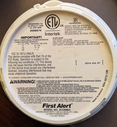

Definitely was the end of life chirp, not low battery. ordered 2 replacements from amazon.
Other one .is a month later date code.

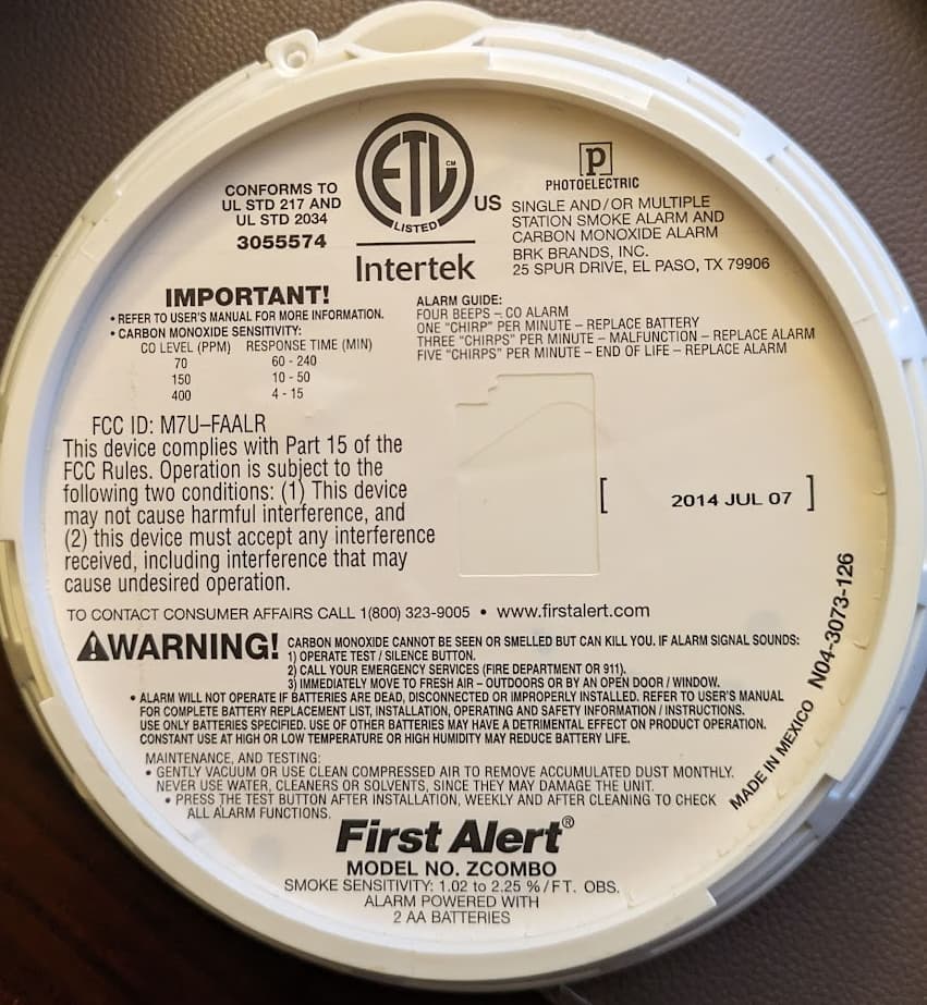

I thought I purchased this unit in 2020 direct from Amazon (I have order history) but the date on the back is July, 2014...
Anyway, I guess it is EOL according to error code.
