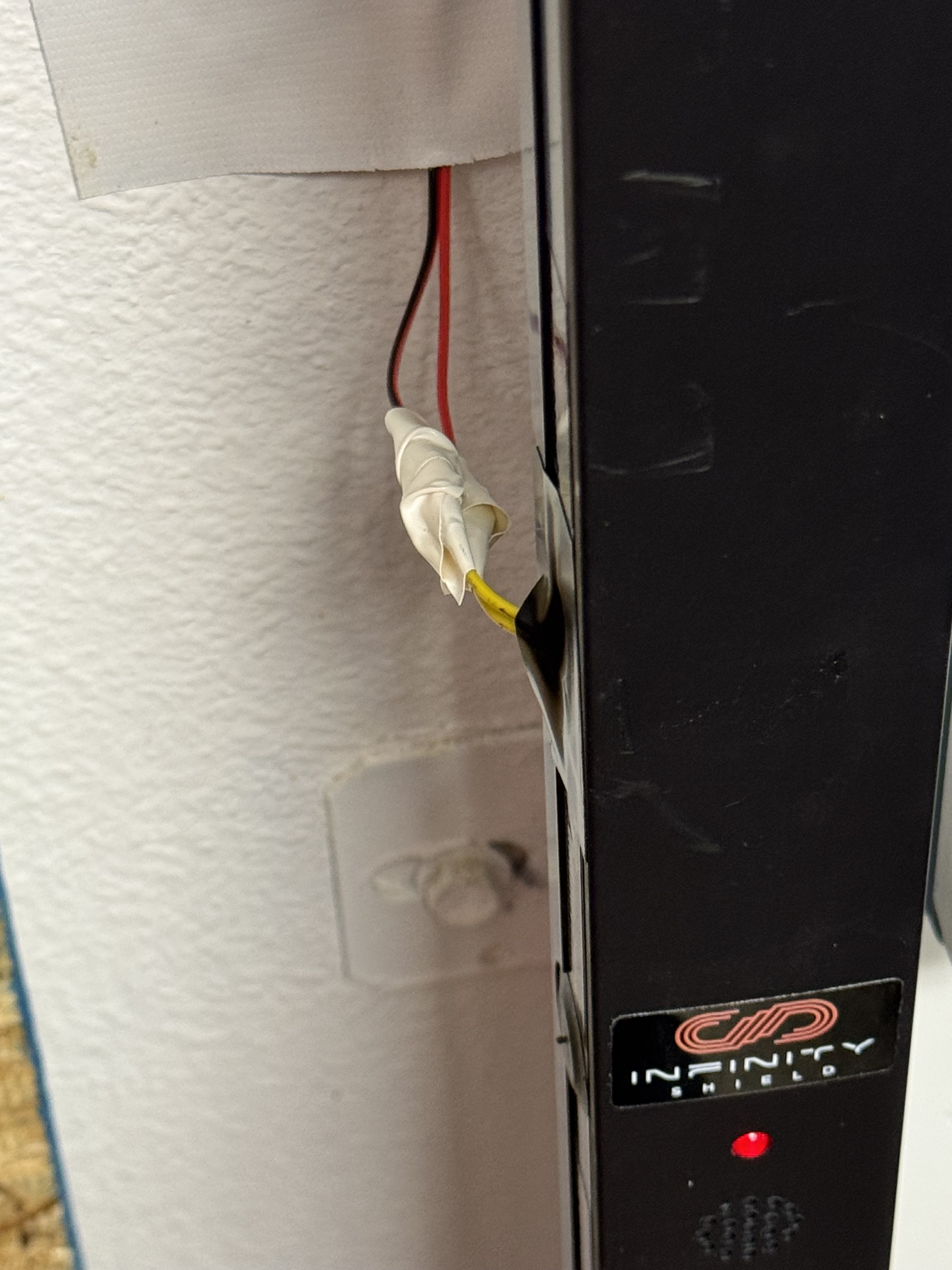

I have this. It's pricy but it works well. My wife turns the beeper off every chance she gets which is annoying. It beeps loudly when something blocks it. So, if you're unloading groceries and the rear hatch is blocking it, it screams like crazy until you're done. But, it does give full coverage of the entire garage opening which is great. I wish it had a "stop beeping for 5 minutes" button.

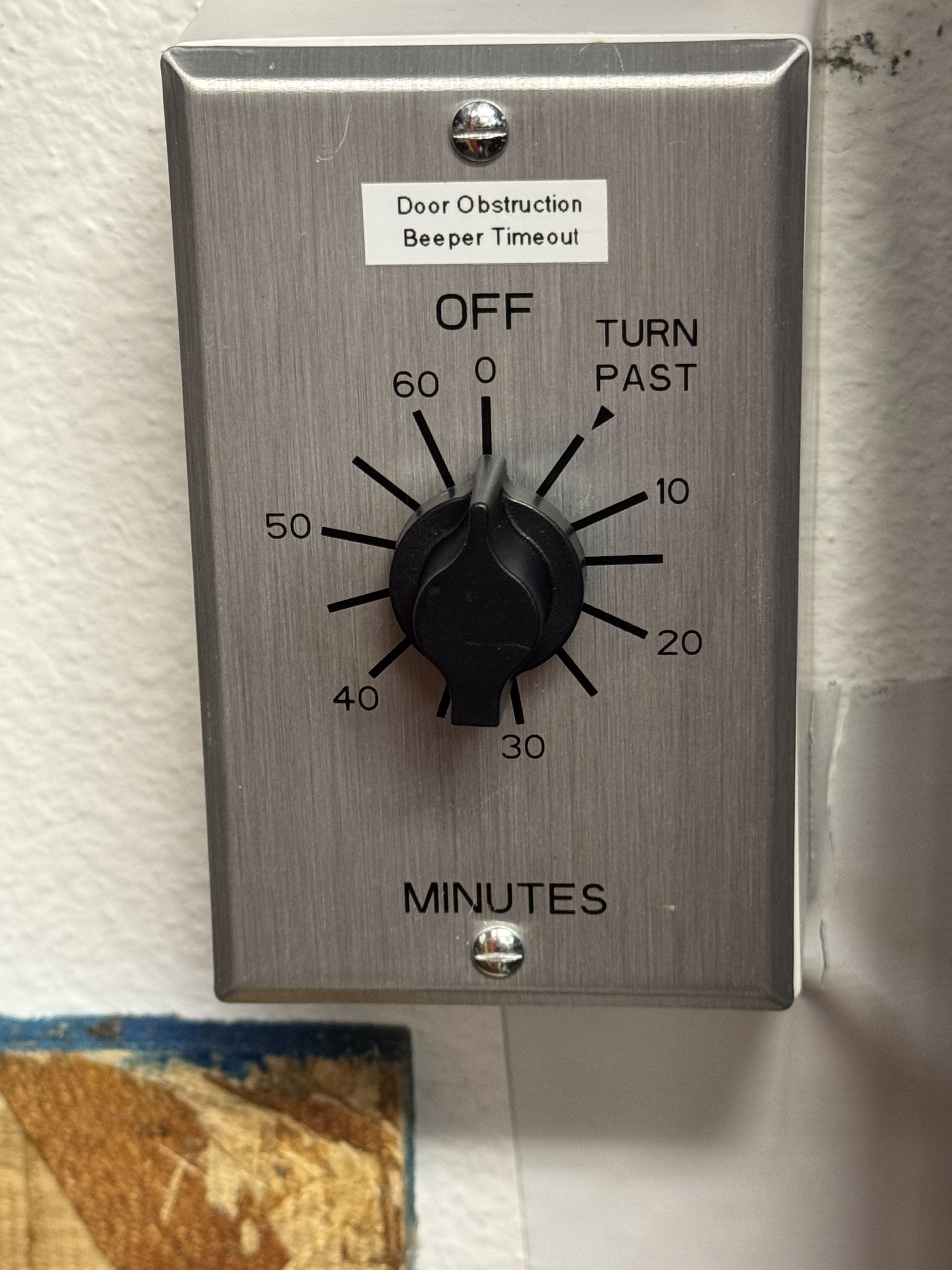

I installed one of these timers, which can be set up as a normally closed switch. Turning the timer knob cuts the low voltage power to the Infinity Shield beeper for up to 60 minutes. Safety function of the Infinity Shield is not impaired in any way.

Genius! So these switches (timers) require no power to run?
Edit: confirmed. That's an amazing idea.
Thank you. Do note that you have to be very specific about what model you get, because most of these spring-operated timers are โ€œnormally openโ€ only; the model I posted from Amazon can be NC or NO, and NC is needed.
This is the electrical box I mounted the spring timer in:
https://a.co/d/dCnGDKr

Interesting. And I remembered that I have an unused Zen17 universal relay. I can use an NC port to turn the beeper on/off and set it up so that I can use a voice command like "Alexa silence the garage door beeper for 10 minutes" and so forth. Hands free, no springs. Not as foolproof as the mechanical timer, but flexible. Thanks for the idea. I hope that Infinity Shield learns of this issue and future models have a "silence for a while" option.
